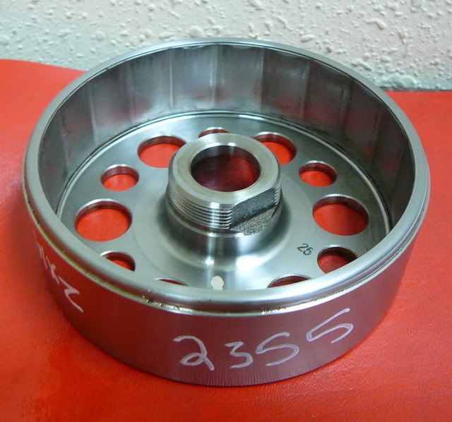

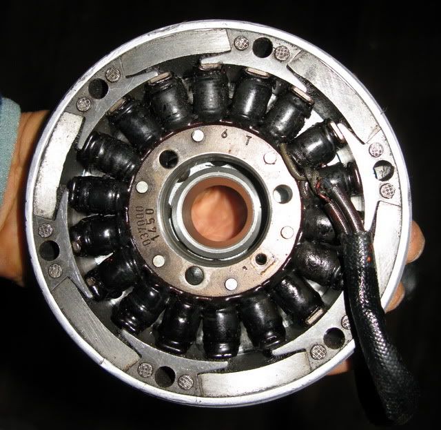

" The gs suzuki 3 phase alternator has 12 magnets/18 coils, "
____ OH, well that then explains why it's stator didn't work for you ! _ I had assumed that it's rotor also had 6 magnet-poles, like the DUCATI-rotor's has.
So I was wrong to figure that stator had 3 sets of 6 coils each, so as to obtain the extra 2 phases (with the 6 magnetic-poles of the duke-rotor).
(Sure was much simpler back in the old-days!)
" the kz kawi 1 phase alternator has 12 magnets/12coils. "
____ If it was a 3-phase instead, it could then get-by with just 4 magnets.
" To obtain 3 phases I would guess the 18 coil stator is wired in 3 sets of 6 coils. "
____ That's what I had thought, until you reviewed that it's rotor had 12 instead of only 6 magnet-poles,, which would make for some kind of square-dance, (without either 6 or 18 magnets).
That it had more than 6 (other than 18) magnets means that each & every coil is not wired/wound exactly the same as it's neighboring coil and/or the stator has it's 3 sets of windings wound & arranged in a matter which requires magnetic-pole flipping every 30-degrees (instead of just every 60). _ So it's got to be wound much more complexly than just the same as three separate 6-pole windings spaced-apart by 20-degrees, (which could work with just the 6 magnet-poles).
" I've noticed that some of the very newest stuff has 15 coils, must be 3 groups of 5(?). "
____ Right, and that would space-apart the coils by 24-degrees,
(and probably use 10-magnets?).
" It now seems obvious that the n-c rotor doesn't work with the either of the newer stators because the magnets are so wide they simultaneously cover the space of two or three of the smaller size coils, canceling each out. "
____ Well that's only because the neighboring coils must not be wound/wired and arranged in successive phased sets, or else it would actually be fine for that width-overlap to occur.
" I wonder if a stator with 9 coils wired 3x3 would work as 3 phase? "
____ That would be quite a puzzle to work-out, since the rotor has to have an EVEN number of poles,, but I assume that 6 magnet-poles could possibly work, so long as the coils are wound & arranged in that tricky set-up -(that makes the 1.5:1 square-dance, between the coils & magnets).
