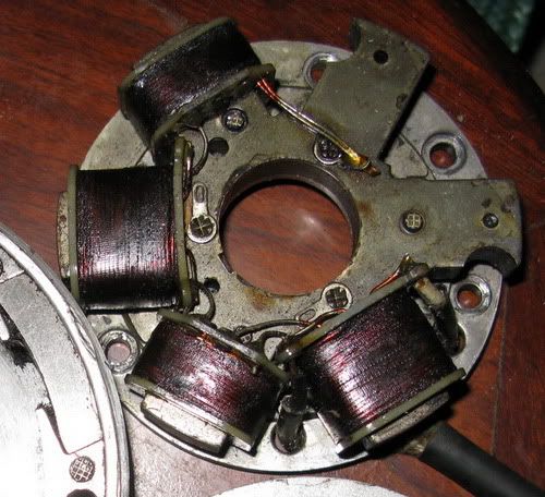

What’s here is a discussion of how to increase the power output of a narrow case 6-pole alternator that includes actual bench testing of various modifications of what started as a 4 coil n-c stator and progressed to various rewiring schemes, installing an additional two coils and still further to modified/adapted modern Denso alternators.
This thread consists of 350+ posts, is lacking in organization, and can be difficult to follow (I backed it up to a Word doc and at that time ended up as 523 pages, 926,825 characters).
It wasn’t really planned, it just happened, so of course has its share of mistakes, failures and dead ends, as well as revelations and successes. It was largely a group effort by DCT-Bob, ecurbruce, MotoMike and myself with occasional appearances by Bevel bob and machten. I look at this simply as an archive, other more specific and functional threads are being created to organize, continue and maybe conclude some of the topics started here. I'll add links here as those works are completed.
What follows as first post here is when I joined in to what was becoming a bit of a contentious discussion and at the time was 8 or so pages into the original thread.
I've been following this thread closely hoping to absorb at least a bit of it but unfortunately the vast majority goes way over my head. I greatly appreciate the efforts put forth to simplify things for us 'uninitiated' types but it has obviously spun out of control in that particular aspect. Every time I think I 'get it' some counterpoint comes up that confounds me yet again. It's like being a juror on a court case where each side is of course presenting a view only advantageous to their side of the argument. I would really like to jump ahead to the 'closing statements' that synopsizes each view, then have the judge explain it all to me in laymen terms, then listen to the CNN analysis. :lol:
However, the more practical 'hands on' aspects of getting the most out of the stock alternator are still within my realm of comprehension and all this has gotten me interested enough to put my test setup back in use.
I previously didn't put much effort into the stock setup as my preliminary tests were fairly disappointing compared to the results with the more modern stuff I was also playing with and my primary goal was to simply outfit my project bike with something that would run a 55w headlight. The number of threads on the subject and plethora of different possible methods were making my head spin and I never felt I got a handle on it so I basically ignored it all and started from scratch on my own terms.
The few basic numbers I previously came up with for the '60w' n-c alternator were specifically at Bob's request and I never got around to set it up again with that alternator to satisfy all his inquiries. Something I also never did was to split the output or even lift the grounded coil ends. Yet another thing I neglected was to load test the straight AC output, I always had at minimum a generic rectifier, as Bob had voiced concern that the random R/R's I was using would skew the results in an indeterminable way.
I still have things set up so as to take reasonable requests for further testing as I'm sure I'm missing some important and obvious aspects...
I don't have a stock R/R so that still isn't an option but I do have many others, from generic rectifier blocks and zener's to 3 ph mosfet R/R's and many things between.
Well anyway, I've some new numbers and they leave me scratching my head a bit.
Not sure how simply grounding/ungrounding the ends would have any affect but it seems to be part of the discussion so I've tried it and included it in the results. I can also take current readings if needed.
Output readings straight off the stator at 3450 RPM, n-c '60w' 4 coil stator, 6 pole rotor. Hopefully I got my numbers right, I never seem to think to write things down, lol.
AC output, no load, stock 'two wire' setup with ends grounded; 31.6vac
AC output, no load, stock 'two wire' setup with ends ungrounded; 31.6vac
AC output, load=55w headlight, stock 'two wire' setup with ends ungrounded; 11.6vac
AC output '4 wire setup' (coil ground ends lifted and separated with wires running out), no load; 15.8vac (connecting meter to either individual 'side' (or pair of wires))
AC output '4 wire setup' (coil ground ends lifted and separated with wires running out), load=55w headlight; 12.1vac " "
So I am appearing to get more output from each individual "separated side" than from the combined total of the two run as stock (grounded) or with the grounds connected/lifted.
If I had though I'd get this result in the beginning, it may have saved me a shitload of time/money/work playing with the new stuff, as I would likely have just used the stocker and not gone any further :(
I haven't yet tried them in parallel (simultaneously) with a load on each, I'll have to dig up another headlight...
Also haven't run it for any length of time and hit it with a temp gun, seems like temperature could be a good relative indicator of duty cycle for the various configurations.

thanks very much for your efforts. finding a resistor to handle 55 watts or more will be fun. a light bulb is a common device for such tests so long as you monitor voltage and current as bob has suggested. can you make some drawings showing the various connections associated with the readings. If you could take current readings it would really help to finish the puzzle. I know it is one of those minds eye things where you know what you mean, but I am not getting how they are connected. Incidentally I respect your attitude towards tackling what some would find a very daunting task. designing and building the jig and test equipment to do your work are no small task.
Bob, trying to pay attention, but think I'd like some drawings of the various connections associated with each of the quoted figures. I am lost as to just how these are connected.
So will reserve an opinion till I can see what is going on.
without knowing the current figures on each, it is hard to say for sure what is going on. I'm assuming that 55w bulb is a 12 volt bulb? If so the only measurement I saw that would indicate a somewhat correct wattage was the 55 watt bulb across a 12.1 volt vac source. that would be 55watts.
I don't think you have enough info in other examples using that bulb without the voltage across and current through to make an informed assessment.
thanks
Mike
Posts: 323
Location: MA USA
Re: 6volt or 12 volt?
Postby wcorey » Fri May 20, 2011 7:36 am
Ok, round two... I will edit my last post to better clarify the results, for some reason the way I spaced the " " didn't carry over to the actual post.
" AC output, load=55w headlight " "; 11.6vac "
____ I gather that this test indicates that the test-bulb had 11.6 AC-volts across it when connected to the original pair of (yellow) wire-leads, (while the internal lead-ends of the two alt.windings remained connected) ?
Correct.
" AC output '4 wire setup' (coil ground ends lifted and separated with wires running out), no load; 15.8vac (either individual 'side' (or pair of wires)) " load=55w headlight; 12.1vac "
____ I gather that this test indicates that the test-bulb had 12.1 AC-volts across it when connected to one original (yellow) wire-lead and the corresponding opposite lead-end of just one of the two alt.windings ?
Correct again.
No problem on current readings but if you know the voltage and wattage doesn't that also tell you current?
Sorry Mike, I'm getting from this I wrongly assumed you were familiar with the physical layout of this particular stator? (or is it just the way I'm describing connecting from the stator to the load?) I'll try to describe it as I see it, though not sure if it will make any more sense than my last post.
There are six core positions, two unpopulated then four coils in a row. It appears that the four are wound in sequence with two equal 'parallel' windings (not sure if they're wound in opposite directions) so there are two wires coming out of the first coil and two from the fourth. The two from one end are the outputs ('two wire setup') and the other two are grounded together to the core, effectively eight windings, grounded in the center. So when the ends are ungrounded, separated and wires added to each, you get the 'four wire setup', obviously creating (the option of) two separate sets of four windings. I take one reading from the stock series setup with the two outputs on one end going to the load with the other two together/grounded, the other reading using one output lead from either end. Getting the same values from either set of separated windings.
The bulb is 12volts.
No worries, I'm a horrible packrat, I checked my box 'o resistors and have a good selection of wattage values, multiple 55w in 1 or 3 ohm, an adjustable 1 ohm at 200w, etc.
But if I can just give you current specs with the headlight that's fine too.
Having a problem getting consistent results with the 'current' current measuring setup, may have to dig up an inductive current probe instead.
When I run right from the stator (with separated coils) to the load I get 12.1vac, when it run it in series though the meter leads (by way of the current function), I get a drop to 11.4vac.
Could be too many crappy clip lead connections...
Maybe this doesn't matter as long as I get a vac reading along with current?
Anyway I see 11.4vac at 4.7a with a 'separated half' and 11.3vac at 4.8a going in series through both sets of windings with the ends (at one "end") attached.

Bill wrote: No problem on current readings but if you know the voltage and wattage doesn't that also tell you current?
MM
this is true Bill. But a 55watt 12 volt bulb will only consume 55watts when it has 12 volts across it. Add to that, the 55watt rating is not very precise but sort of a ball park figure. It won't be too far off the mark as as manufacturers spec a given rating for a bulb in their vehicles, and if you run too high on current you'll run into trouble with overheating the vehicle wiring and switch gear. But it is not uncommon, especially for headlight manufacturers to fudge a little to get more light out but still rate it at 55watts so produce more light than the competitors.
I am somewhat familiar with the stator setup, but some of your measurements don't make sense to me and I attribute that to me not understanding how it is wired. That is why I like to have a simple schematic to look at.
Thanks for all the lab work
Mike

wcorey wrote:
MotoMike wrote: If you could take current readings it would really help to finish the puzzle.
____ As I had meant to indicate, lightbulb-filaments increase in resistance as they go from warm to hot, thus claimed wattage-figures are not as reliable when at voltages other than is expected.
" Sorry Mike, I'm getting from this I wrongly assumed you were familiar with the physical layout of this particular stator? (or is it just the way I'm describing connecting from the stator to the load?) "
____ I-myself correctly understood what your wording had meant to convey, but for others' sake, I put your test-connections in other-words (which you've confirmed as correct).
Perhaps it would've helped further for others to realize that I've always recommended using two separate pairs of wire-leads, (one pair for each alt.winding), so as to more completely isolate the alt.windings (to prevent any otherwise possible current-flow interaction).
By your adding your pair of additional wire-leads (connected to the otherwise grounded pair of internal alt.winding lead-ends), and effectively bringing them out along with the original (yellow) pair,, you have done as I've recommended.
" I'll try to describe it as I see it, though not sure if it will make any more sense than my last post.
There are six core positions, two unpopulated then four coils in a row. It appears that the four are wound in sequence with two equal 'parallel' windings (not sure if they're wound in opposite directions) so there are two wires coming out of the first coil and two from the fourth. "
____ This so far seems clear enough.
" The two from one end are the outputs ('two wire setup') and the other two are grounded together to the core, effectively eight windings, grounded in the center. "
____ In other words, each of the two alt.windings have their two/opposite lead-ends soldered to the stator-plate (at one end), and a dedicated (yellow)- wire-lead (at the other end), with their lengths both wrapped-around 4 core-coils, (those 4 coil-windings connected in series).
" So when the ends are ungrounded, separated and wires added to each, you get the 'four wire setup', obviously creating (the option of) two separate sets of four windings. "
____ All well-put except at the end of the sentence, where I'd state: "two sets of four coil-windings to make-up each separate alt.winding".
" I take one reading from the stock series setup with the two outputs on one end going to the load with the other two together/grounded, "
____ That's the test that's done with the two alt.windings connected in series-fashion.
However I feel the need to make it clear that the wording: "stock series setup" is misleading, since the stock-system in no way makes any use of those two alt.windings in 'series' ! _ (As I'm sure Mike will agree!)
Cuz due to them both being grounded, they must then be used in 'parallel' fashion. _ (Which I gather Mike doesn't agree.)
" the other reading using one output lead from either end. Getting the same values from either set of separated windings. "
____ I gather this to be in reference to the testing of either alt.winding alone, (still in AC testing-mode).
" I checked my box 'o resistors and have a good selection of wattage values, multiple 55w in 1 or 3 ohm, an adjustable 1 ohm at 200w, etc. "
____ The 200-watt unit (adjustable from 1-ohm to ?-ohms), sounds like a monster, and possibly the best choice for such testing.
" But if I can just give you current specs with the headlight that's fine too. "
____ Current AND voltage, that is.
" Could be too many crappy clip lead connections... "
____ Right, if not solidly-firm connections, they too will have a voltage-drop across them (and likely get warm or even hot to the touch), thus robbing the load of (a fraction of) the full power-output (of the tested power-source).
" Maybe this doesn't matter as long as I get a vac reading along with current? "
____ That's correct, providing you measure the voltage-output of the power-source rather than the v.drop across the bulb/load.
