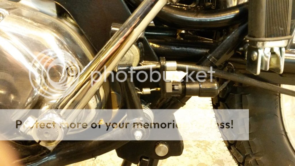

I recently put the Electrex flywheel/stator/rectifier on my narrow case 250. For the wiring I just use two toggle switches, one for lights, one for ignition. There are plenty of small 12V batteries out there that'll work fine. I found a scooter headlight bulb that (sort of) fit the stock headlight lens and it throws out plenty of light. For a brake light you can use an old Triumph/BSA front brake cable that has the brake light switch in the cable. There are also modern scooter/bike parts that'll do the job just fine, or use the stock brake light setup.
Anyway, I'm very happy with the system. However, I've saved the old flywheel/stator for any future owners that might be deranged enough to want to resurrect the stock Ducati electrical system. (You'll note, however, that most of those types seldom ride their bikes.)
Back in the seventies I rode my then rusty and unrestored 250 MkIII all around the Venice area. I not only rode the bike to U.C.L.A. almost daily, after school I strapped my toolbox on the seat and rode it around Marina Del Rey where I worked as a marine engine mechanic. Too much fun!
The rectifier and toggles are mounted on an aluminum plate under the seat - see pic
The bike also looks a bit better these days...
