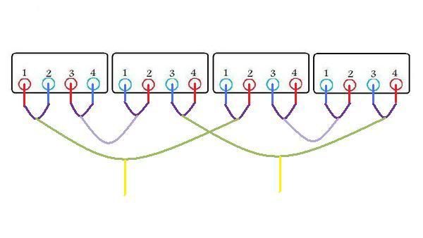

Re: Troubleshooting Alternator Wiring
" it seems in one of those
past schemes I must have wired the stock coils to have similar effect but can't recall. "
____ I only recall of you unchaining each power-coil's dual-windings (from their two individual stock stator-circuits), and then reconnecting them rather to each-other in series-fashion, (but never together in parallel).
There were quite a few tests/schemes I had done back then that went 'unpublished', simply due to lack of time in many instances.
It of course has occurred to me well after the fact what I had been up to, that lead to this particular concept/scheme.
Toward the end of the past project, I had worked out a parallel-from-hell scheme (you'd think of it more as an imbalance-mismatch-from-hell)
that more or less maximized just how parallel the stator circuit could possibly get.
But by then, reducing the winding resistance had become less of an issue so I never bothered to actually implement it.
I was also concerned that the imbalance issue that appeared to me to be minor on the 'e' scheme and single rec 3-sec scheme
would likely become much more aggravated by this one.
If I get motivated enough, I just might try it though.

- Posts: 318
Bill , it looks like the maximized parallel scheme you show is what we would be doing with the double wound spools. We will be right back to two coils per spool. The advantage I can see to the double wound version is that both coils would be in the same close proximity to the permanent magnet field, and I can get more wind-turns on each bobbin than Ducati used.
I am going to be out of pocket for the next ten days, don't think I'm jumping ship, I'll be keeping up in the background. When I return, I plan to do some winding, if you do get motivated to configure and test that maximized parallel system in the mean time, we'll compare it to the double wound version when I can get it done, what do you think?
Meanwhile, Bill do you have an opinion on wire size for the double wound coils?

Winding-parameter Considerations
____ Just as I was going to begin a response to Bill's post, Bruce's (more pertinent) post popped-up, so now I'm led to post under IT instead.
[quote= ecurbruce ...
" Bill , it looks like the maximized parallel scheme you show is what we would be doing with the double wound spools. "
____ No, not-quite THAT-extensive,, as the large/small power-coil pairs (within each of the three sections) will still be rather connected in series to each-other !
__ Bill's ultimate-parallel scheme would have ALL-12 individual windings all connected-together in parallel !
" We will be right back to two coils per spool. "
____ Yes but, I wouldn't say "right back",, cuz the intended 'double-wound' coil-pairs will be exactly the same length as each-other (instead of the outer-windings being slightly longer than the inner-ones [as with Ducati's 'dual-windings') !
" The advantage I can see to the double wound version is that both coils would be in the same close proximity to the permanent magnet field, "
____ While that may be a slight viable consideration, (since the original dual-winding's loop-sets don't cut the very-same flux-lines),, the REAL 'advantage' of the 'DOUBLE-winding', is that it's resulting winding 'pair' is naturally 'MATCHED' , (thus no interaction losses) !
" if you do get motivated to configure and test that maximized parallel system "
____ Even though having divided-up the set of 6 power-coils into 3-pairs and connecting-up the resulted 3 series-sections in parallel with each-other, has already quite well proven the case,, showing that the resulted output-voltage of all 12-windings connected in parallel is STILL just as high as if all were connected in 'series',
would even more-so prove-the-point that alternator-windings (unlike battery-cells) do-NOT produce their-own 'voltage' !! - (Since 'voltage' can ONLY be 'added' in 'SERIES' !) -
In other-words, IF each individual stator-winding actually produced any pre-established/true 'voltage' , THEN that ultimate parallel-arrangement would only provide just 1/12th as much voltage as all twelve coil-windings arranged in series ! _ BUT that established series vs. parallel voltage-law is-NOT followed by alt.power-windings, (as is commonly ASSUMED) !
That seemingly rule-breaking revelation, is evidence for why the commonly-conceived 6+6=12 concept, (as promoted in the mag.article), is INCORRECT !
