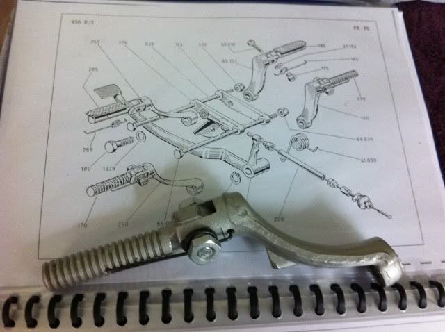

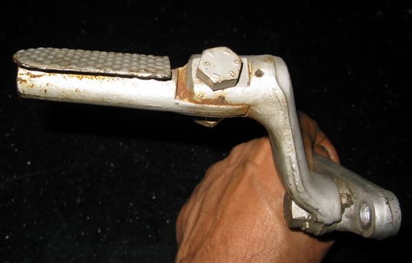

My right peg has a slight up angle similar (but maybe a bit less) to yours and appears to be intentionally made that way as opposed to being bent after the fact. It has the stamped diamond pattern metal plate as Eldert mentioned. To straighten it, seems that the peg could be milled/ground down where it stops on the pivot instead of bending the arm.
Can't say as I ever recall seeing one with rubber pegs. It seems odd to have a rubber over the return spring and with no provision to hold it onto the peg. Or does yours have a protuberance of some kind on the end? Is there any evidence on yours of welds being ground off where the plate may have formerly been? Would've been two beads on either side, one pair near the base and one pair near the end.

Hello Bill,
The right peg mount is nearly level when fitted to the bike, it's the left that seems to me to be bent.
Here is the left peg (the right is the same style) without the rubber. The rubber is a bugger to get on and harder to get off.
Also the parts manual I have showing the 2 different foot pegs. It does not show the rubber though.

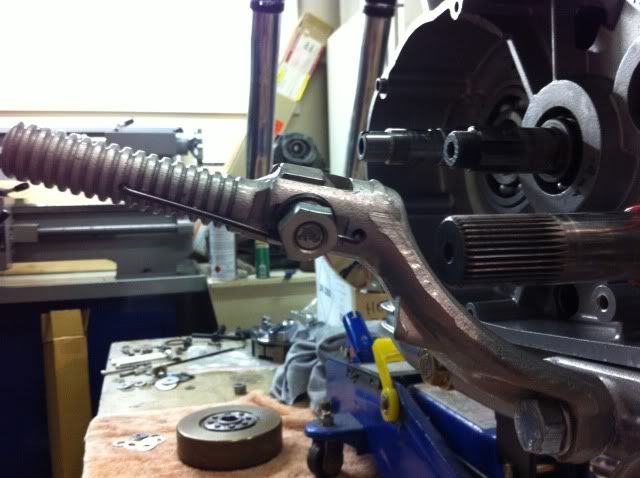

Here is the bare foot peg assembly fitted to the bike, you can see the main curved bracket's end, where the fold up piece sits isn't flat.
I can see the fold up piece makes the up angle worse, but my question is whether the curved piece should end flat? In which case it's bent.
Hope that makes sense, and thanks for your input.

Yah, looks to me like the arm is bent, shouldn't be that difficult to bend back. I'd bolt it to something solid (other than the bracket/motor case), take the peg off and find a heavy pipe to go over the end of the arm (or drill an appropriate hole in the end of a solid bar) and have at it cold. Probably wise to put a spacer in the peg slot to avoid pinching it. I bet you'd be surprised how easy it is to move with a few feet of leverage...

____ The foot-peg's support-bracket certainly seems bent upward.
__ How does the condition of the motor-casing's mounting-bosses (where the fastening-bracket is fastened to the frame & case), appear to be ? _ Those alloy-bosses are often (at least) cracked-up on such off-road w-c.models. _ And I'd think that yours were at least stressed if that peg-bracket was on your Duke at the time when it got bent.

The two lower "lugs" on the cases are in good condition with no signs of trauma.
This is why I'm questioning the shape of the curved cast steel foot peg mount. It would take a lot of force to bend it that far without damageing the alloy case lugs. Or as you say the bolts were very tight.

The colour was silver like Bill's picture.
