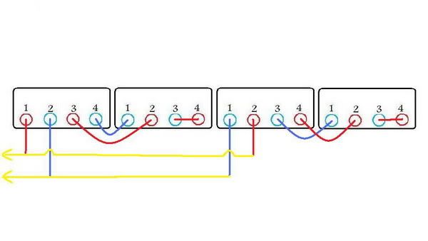

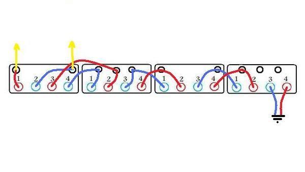

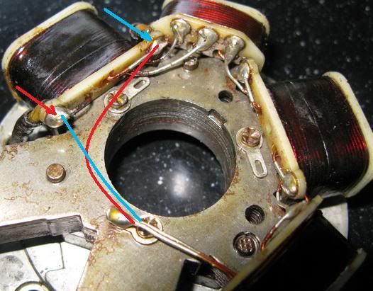

The narrow case alt we’re covering here consists of a 6-pole rotor and a 6-(pole?) stator with actual coils on only 4 of the 6 available core/post positions. It’s feasible to install the two additional coils but the bolt pattern on the mounting plate is such that if one of the missing coils were added it would obstruct access to one of the mounting holes. Bruce explains how to get around this here; viewtopic.php?f=3&t=593. There is a similar wide case stator but it already has coils on all 6 cores and a larger diameter mounting plate that avoids the obstruction issue.
The n-c stator’s coils are wound in a unique scheme that has two separate windings on each coil bobbin, an inner and an outer, both wound in the same direction (I still have reason to question the winding direction). There are two larger coils wound counter-clockwise and two smaller coils wound clockwise that alternate large/small/large/small around the stator. One winding on each coil is connected in series to the next, creating two individual sets of 4 windings, one set all the ‘inners’, the other all the ‘outers’.
The two sets are connected at one end and grounded to the stator core, the other ends are the two output wires that go to the R/R.
The stock n-c rectifier/regulator (R/R) half-wave rectifies each of the alternators two winding sets (in parallel with each other). This can be called dual half-wave rectification, which in this case is a type of full-wave (F/W), sort of…(½ + ½ = 1) but still only taps half of the available power.
Using F/W rectification on each winding (1 + 1 = 2) would seemingly provide double the output but to use the stock alt with a typical F/W bridged rectifier, the grounded ends of the two winding sets need to be lifted/isolated. This defeats the original parallel type arrangement and creates a series circuit through/including both sets, doubling the resistance, resulting in an impedance mismatch with the load. This in turn decreases the expected available level of output to somewhat more than the stock configuration (?... never tested with stock R/R) but nowhere near double.
If the grounded end is lifted/separated and output wires are attached, then each winding can be individually F/W rectified and so the current path (and resistance) is cut back in half. The outputs of the rectifiers can be combined, kept separate and/or switched in or out of use in various combinations. This is a type of setup Bob has recommended in earlier threads and has proved to have advantages over the stock series/parallel (‘popular ground lifting’) mod.
Looking at how we arrived at our current conclusions (in a very condensed timeline) it seems that the first significant thing we came across was the disparity of output when running a single one of the two stock/original winding sets produced almost as much output as both combined. This was a head scratcher and turned out to be a major obstacle to overcome. Though the impedance matching issue had also been suspected at around the same time, we got sidetracked thinking that the inner/outer coil arrangement could have been causing some sort of 'AC-DC-interaction-counter-electro-magnetic-canceling-whatever' effect when the alt was run in various other-than-stock configurations. A bunch of half wave testing was done that lead nowhere (in that regard anyway) other than to disprove that line of thinking. Seems to me the ‘Grand series’ was conceived to also test that theory but also dead-ended for that purpose (?).
Through much of the earlier testing I was taking it all pretty casually and it took a while before I got serious and adopted a more methodical approach. But not before ending up with some clerical mistakes and confusion with terminology, that then lead to erroneous conclusions and a few dead ends.

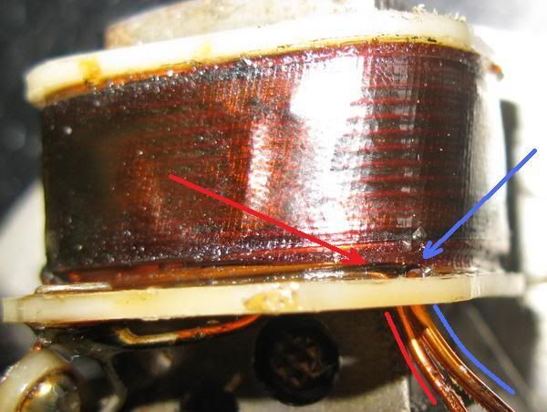

Bruce dissects a couple stator coils and we get some confirmation of what’s going on in there.
Bruce’s Dad donates two stator coils to ‘the cause’, allowing me to add an additional two coils in series to the vacant core/poles on the four-coil stator. This yielded more power but as it was still a version of the ground lifting mod, further increased resistance and somewhat compromised its effectiveness.
The impedance matching issue that had been earlier side-barred turned out to be the big culprit. It eventually became apparent as such through higher ohm value testing as well as various setups of series/parallel coil combinations. Figuring that out was probably the single biggest turning point and opened the door for what was (and is still) to come.

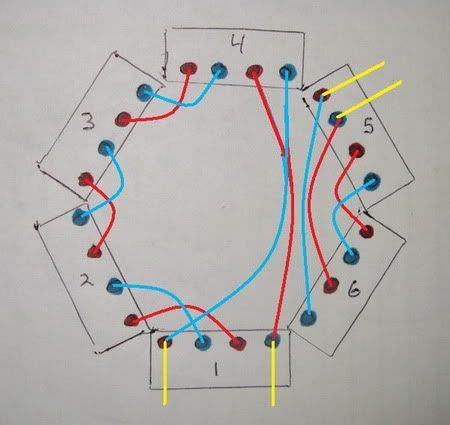

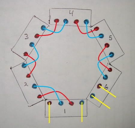

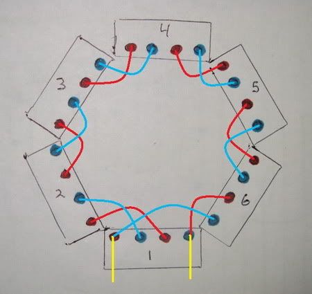

All this seemed to nullify the notion of any big advantage to the popular modification of simply lifting the grounded coil ends for higher output with 12v conversions and further indicated that the original series/parallel combination has at least some good reasons for being that way.

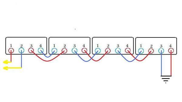

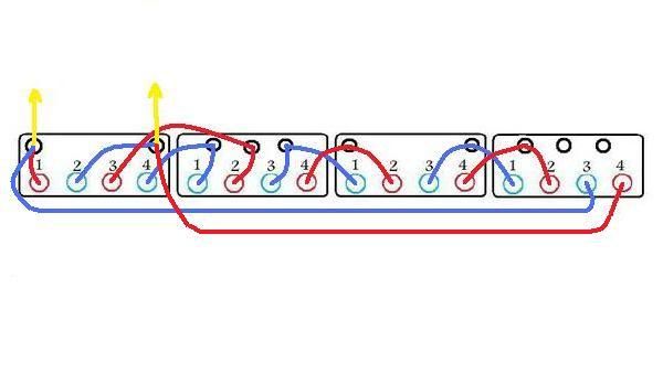

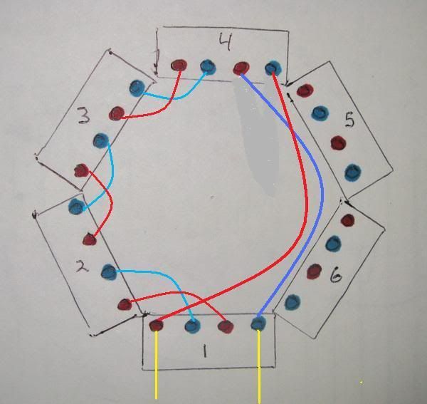

Rearranging the coils to the 'grand series' scheme (rewiring to integrate the inner and outer windings (in series) on each core, then the six coils connected to create one continuous series winding) resulted in the same output as the ‘series, grounds lifted’ and the working impedance was still too high. Did testing with it at higher ohms and got highest results yet (6k rpm, 14 ohm, 173w). That in turn lead to the '3-section' mod (splitting the series of six coils into three equal pairs) and individually simultaneously F/W rectifying each of them and then still further to combining the outputs of those 3 sections in parallel into one pair of wires with one F/W rec. Both of which reduced the resistance and produced peak output at a more useable working impedance. The 3-section seems to have resulted in the best of an acceptable ratio of output to rework effort required to accomplish it. Debatable, I’m sure…
The success of the 8-pole, 6-coil, three section, 3-phase mod was the final step for the stock alt mods and marked the point where things got 'over the top' as far as how much performance benefit could be had for how much modification effort was required to get it there (due to the rotor mods also required).
So the single-phase, 3-section mod seems to be ‘it’ for now, though using only the original 4 coils in 2 sections may provide enough output for the majority of situations. What are the other ‘new’ options that fall somewhere between that and the stock config?

I did some new 'visual aides', the first one below one depicts a stock 4-coil stator with the jumper points included much as they're actually seen (though shown in a straight line, obviously). Each rectangle is a coil/post on the stator, the blue circles/lines trace the path of one winding set, the red the other. The black circles are the jumper points which on the stator are grommets set into the protruding plastic flange at the bottom of each coil and serve as solder connection points. the yellow lines are the output wires to the R/R.
The second picture is the same thing but simplified into more of a a schematic type form and is what I'll likely use to depict future connection schemes. I'll add a couple other types further on for some different perspective, hopefully between them all a coherent pattern will emerge.

So when I put the stator back to the stock 4-coil configuration, I used four output wires so to be able to try many of the various arrangements with one setup by 'switch-boarding' the wires. The two additional wires are from the two ungrounded ends. In past threads DCT Bob had recommended the ‘four wire mod’ even if there was no immediate plan to use all of them, to allow for future options without having to further access the alt in the motor.

The first one I thought of was a very simple variation of the stock stator. I couldn’t help but wonder why this one never came up early on.
Instead of lifting the grounded ends, then adding an output wire to each and using those along with the two original outputs to go to two separate F/W recs, I just combined the two original outputs and used it and the ungrounded pair to go into one F/W rec, much to the same effect as the ‘3-section with combined outputs’ type mod but with unaltered coil windings. That would cut the working impedance in half again (to a quarter of the ‘standard’ ground lifting scheme) and could also be extrapolated to the six coil config, (resulting in a bit higher working impedance than the ‘3-sec’ mod but likely still within acceptable range)…
This seemed too easy… What was I missing, ‘canceling effect’? Yup… (If two windings on the same core/post are connected so the current flows in opposite directions to each other (resulting in opposite polarity), they cancel each other out.)
It didn’t have any output, I believe due to the polarities of the inner/outer coil windings effectively being backwards on one winding set (I’ve tried unsuccessfully to explain what I mean by that way back in a previous post). If each coil on one winding set were reversed I figured it would work but then ends up being almost the same amount of rework as the ‘3 section’ type mod.
The top one is how I actually connected it and the bottom one is how it would have to be done to work.
Then a light bulb lit
and I thought of a simple way to do it without rearranging the individual coil connections, I swapped/reversed a wire on each winding set one to the other. This worked and produced an acceptable result, 48w at 3450 rpm, on the ‘standard bike emulation setup’.
When I then put it into schematic form, I realized that I had simply reinvented the wheel with Mikes tricky and ingenious ‘E’ scheme that had originally been tested in 6-coil form with good results but was never really pursued when we moved on to other things. (I think that was due to a combination of all the half wave testing and other discussions wanting to be settled with the ‘foam bat’, lol.)

The very most interesting/baffling/surprising test was when I put Mike’s ‘E’ on the FH008 Mosfet R/R, 5.26a, 13.47vdc, 70w! Where did that come from?!
I put it back on a different generic rec and back to 48w, I put the ‘lifted ground/series’ on the Mosfet and got 48w. An aberration…, but a good one… More magic wand stuff…
Mikes ‘E’ scheme, depicted in various different pictorial formats, I'll probably continue to use one or more of these to depict other future mod schemes.
This one includes the stock attachment points...
This one is in schematic form...
On this one the grounded ends would need to be separated...
Colors on this one are transposed from the other drawings but it's still functionally the same.
Which wire goes to which winding set needs to be determined for many of the mod schemes. Though both 'end' wires emerge from the same hole on both of my stators, it's easy to visually ascertain which is which. Ringing it out with a meter is the fail-safe way but as can be seen in the photo, they can be differentiated as noted.
Next up was a hybrid between the ‘lifted ground /series’ and 3-section mod, a sort of 2-sec parallel/‘lifted ground /series’.
I disconnected the wires between the 2nd and 3rd coils, connected the 2nd coil pair ends together and also connected the ends on the 4th coil pair. Added an output wire to each of the 3rd coil leads.

What I’m going to cover here is the installation of two additional coils on the two vacant core/post positions, the basic version that simply stays with the stock coil connection scheme. Still not a real DIY, haven't been ambitious enough to take that on, just downloading more info for those who wish to use it.
The ‘3-section mod’ that has proved to provide the highest output requires a bit more extensive modification and may have more output than is required by some so what's here will be yet another intermediate step in the ‘modification hierarchy’.
Running the 'stock like' 6-coil on the ‘standard bike emulation’ setup with the Shindengen FH mosfet R/R, I got 75w at 2500 rpm, 98w at 6 ohms, 3450rpm (instead of 24 ohms as with the standard setup) and 6k rpm yielded 120w.
Using a generic F/W rectifier reduced most of the mosfet output figures by about 20w but was within about 10w at 6k rpm, so the added efficiency of the mosfet seems to be more apparent at lower rpm’s. An effect of frequency maybe…?
The output of the ‘stock-like’ 6-coil arrangement seems to be held back to some degree (in comparative relation to the 4-coil output) by the impedance matching issue, due to it’s increased wire length (resistance). This is likely why the 6-coil responds well to the ‘3-section mod’ where the 4-coil doesn’t see the same relative benefit from this method. Also possibly why the 6-coil stock w-c alt is rated by Ducati for only 10w over the 4-coil (when it should logically be 30w more)...
To accomplish this mod, two more coils from another stator are obviously needed. The donor coils, once disconnected from each other, slide on/off of the ‘core posts’ after the retaining tabs are bent up straight. There appears to be two different methods by which these tabs are employed. Bruce found the coils on his stators to be retained by separate copper clips that slide in between the post and coil (described here; viewtopic.php?f=3&t=593&hilit=nc+stator+wc+250 ). On the one Bruce's Dad disassembled and both of mine, the last ‘layer’ of sheetmetal the laminated stator core is composed of is simply bent over.
Though only the two output wires from the first coil are required, rather than making the connections of last two coil wires right on the stator I would suggest running them out with the other pair, then the various connection scheme options can be implemented externally to the motor by appropriately combining the wire pairs. Also provides extra insurance in case you get something backwards, lol.
Either of two formats would be practical depending on personal choice. One method is to add the additional two wires to the last pair on the sixth coil, enabling anything from ‘stock-like’, to ‘lifted ground’, to Mikes ‘E’.
The basic two wire version connected as 'E'...
The four wire 'universal' option...
The other (with slightly more complex wiring) is a variation of Dct-Bob’s preferred type setup with a ‘balanced system’ and no requirement for a regulator (the operator becomes the regulator). Pick one of those schemes (‘E’ would be my pick) and do a 4-coil section and a (separate) 2-coil section. Then use the 2 coils that will easily provide low rpm break-even without the headlight and switch in the other 4 (going to a separate rec) when the headlight is on. The outputs of the two rec’s can be combined and with a single or double throw, 4-pole switch they could be actuated simultaneously or be separated for increased optional manual control (2-coil, 4-coil or 2+4 coil).
This seems to be becoming a habit, I found something very odd while playing with this configuration. I usually try just about every possible combination of (output wire) connection schemes when I test these multiple output wire setups, even if I’m pretty sure it won’t work, it’s quick, easy and doesn’t hurt anything.
One thing I tried here was running both sections combined into one rec and as expected it put out slightly less power than just the 4-coil section separately. The 4-coil section had a red and white output pair, the 2-coil section had black and green. For this to work at all (to keep the polarities right) red had to be paired with black and white to green.
As I finished reconnecting the 2 coil pair back to it’s own rec (with the alt still spinning) I saw the headlight briefly get brighter. Turns out I had shorted the green wire to the red wire, while both were running on separate recs with the outputs combined. I re-connected the red and green and got increased output power near that of the 4-coil 'E’ with the mosfet R/R, 72w at 3450 rpm (6-coil with generic rec was about 57w). I tried every other similar combination I could think of and none had a similar beneficial result.
On paper it doesn’t make sense to me that it even works at all.
Every time I think I’m starting to understand things a little better something like this happens that reminds me of how relatively clueless I still am with this stuff...
