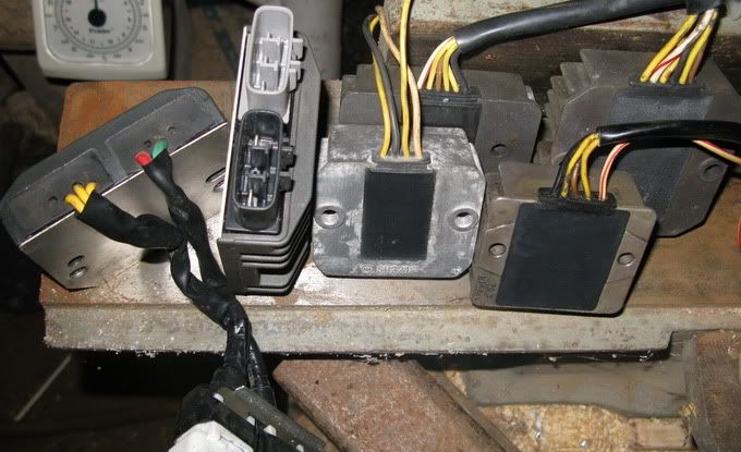

Tested R.R-unit... "3 phase" or not ?
By: wcorey...
" It's a three phase reg, has three inputs like all the other three phase reg's I have,"
____ Right, I had figured that's the type of R.R-unit you had, and I'm glad you've confirmed that it's like most other 3-phase type units... All such units that I've ever known of, have 3 separate std.type inputs - 1 input for each of the three phased outputs (of the 3-phase alt), PLUS the 'common' input, for a total of 4 separate inputs -(input-terminals).
I now assume that what you must have actually meant, was just three separate 'pairs' of inputs,, which is a total of six wire-connections between the 3-phase alternator & the R.R-unit. _ But three of the six can be combined into just one connection, thus making the 4th wire a "master-type" 'common' wire (for 1, plus the other 3, for 4 total inputs).
Does this now clear-up our confusion on this issue ?
" never seen or heard of a 'master-type 'common' input' on one. Even single phase alt's have two output leads. What is the function/use of a 'master-type 'common' input'? "

__ I don't understand why this wasn't already clear to you... Does yours really have three full 'pairs' of inputs ?
____ That doesn't make sense to me ! _ I'm now thinking that perhaps your supposed '3-phase' type R.R-unit is possibly just a 2-phase unit. _ As a 2-phase R.R-unit would have 1 'common' input, plus 2 std.type inputs -(one for each phase).
So this could be the actual solution to our prior confusion-issue, (if your R.R-unit actually only has just three SINGLE inputs).
__ Do you have any pix of your chosen R.R-unit ?
____ It's function is to simply cut-down on excess wiring ! ...
It's understood that a 'single-phase' NEEDS one pair of connecting-leads (for it's single pair of outputs), but while a 3-phase would thus seem to require the use of three pairs, it actually only needs three single connections plus one 'common' -(master-type) connection-lead, (which must handle all the opposite polarities of each of the three separate/phased power-outputs), thus saving two lengths of wire-connections plus their related output and input terminals !
Do I need to draw-up a digram ?
" Tried it already but got very low output, like a couple volts. "DCT-Bob wrote:...you ought to connect each of the three sections to a dedicated input on the R.R-unit, (as expected for a 3-phase type unit, [even though being fed a single phase]).

The typical reg/rec that I have has either 2 or 3 yellow input wires (depending on whether single or 3 phase), and two output wires (pos/neg), a red or red/white and a black or green. Some have an additional brown wire that goes to the ignition switch and I believe 'shuts off' the reg when not in use so the battery can't drain back through it, eliminating the need for a heavier cutout switch that would otherwise be required to handle the full current load of the battery.
The typical stator I have has either 2 or 3 output yellow wires (depending on whether single or 3 phase) that connect to the reg/rec. The red/pos goes to the bat and the black/neg is ground.
The Shindengen 3ph mosfet units have five connections, three inputs and two outputs, the FH008's have a pigtail to the connectors and the FH010/11/12's have the connectors on the unit directly. When used as single phase, the two (yellow) stator wires go to any two of the (yellow) reg/rec inputs and the pos/neg go to the load (bat/cap/light/whatever).
Since that regulator had allowed such a high voltage (as 14.8v), I'd say that it's meant to depend on a std.battery for help (with holding-down the voltage-level).
I'd assume that the vast majority of reg's that come on modern stock street bikes are designed the be used with a battery.

I'm unclear on this, sounds like you want to short each section to itself then connect each shorted section to the reg/rec inputs? Otherwise how do six wires go to three inputs?
Seems like I'd need a reg made for a 'wye' configured alt to have a chance of it working.
An interesting thing about the 'wye' configuration is that it puts out higher voltage at lower rpm (and higher peak wattage output) than the 'delta' type but the delta has a lower working impedance.

" the newest arrangement (of the three-sectioned stator 'delta emulation' to the FH008 rec/reg as I think is depicted in bobs illustration) produced more or less the same failed result as the 'other' way, about 4vdc with the caps and no load, 156mv with a load. "
____ Well that's quite very disappointing ! _ As it really should not mater whether the outputted power from the three sections are in-phase or not.
Of course MotoMike is right that internal circuit-diagrams are really needed in order to realize exactly how the related circuit handles the power-juice connected to it.
So rather than suspect that you somehow made some kind of miss-connection to your R.R-unit, I can only conclude that the inputs of your unit internally do-not directly connect-up to such a 6-diode rectifier-arrangement, as depicted.
To properly understand what that R.R-unit does, we'd need to see it's specific schematic-diagram plus that of the 3-phase alternator which it was originally intended to work with.
__ How about trying-out another/different 3-phase type R.R-unit you have ?
____ Okay, I hadn't understood that the "wye" type is the "star" (or ' Y ') type... I have no problem at all accepting those stated differences between THAT type and the Delta-type !
However, the Delta-type (with it's 3 'commons'), ought to have pretty-much the same characteristics as the type ("B") with the 3-regular + 1-common type connector-leads. _ As the only noted difference is the method-type used for THE connections !
" Not that internet info is always reliable but I got that from multiple sources, "wcorey wrote: An interesting thing about the 'wye' configuration is that it puts out higher voltage at lower rpm (and higher peak wattage output) than the 'delta' type but the delta has a lower working impedance.
