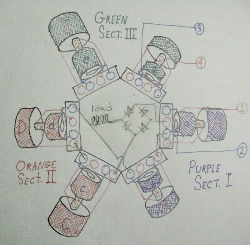

" I would have to say this drawing is more a logical arrangement
, and best used to organize schematic drawings in a logical manner.
Looking at my stator, this doesn't match exactly how the leads are arranged literally,
____ In that case, your drawing will still not be fully helpful to Bill (for figuring-out exactly what's what).
It's too bad that Ducati didn't construct all their dual-spools consistently in some particular logical manor.
" To wire the stator is still going to take some continuity testing just to see where everything is going, but to depict it in the drawing the way it really is would further confuse things (logically) for schematic drawings. Bill had noted that there was one spool that was backwards or reversed and depicted such in his drawing,
____ I understand what you mean about how an actual/real-life depiction would have a non-logical/screwed-up and thus confusing & disconcerting appearance, but still, that's the kind of representation which is actually needed.
" Here is a version of drawing depicting the seperate sections I think the way you described. "
____ That's right...
Rather than having to refer to each 'coil-spool pair' as: "Aa/Bb" or "Cc/Dd" , now that we have a third segment/section -( Ee/Ff ), it's just more straight-forward to simply refer to each as: 'se.I' ; 'se.II' ; & 'se.III' .

Fully-drawn Stator (with Dual half-wave
" Bill, can you draw (insert) this schematic into the multicolored drawing that I supplied Sat. June 18 1031 PM? I think I'm lost on this one. "
____ Bruce, when you wish to identify a particular post by date & time, ya have to obtain that specific data when you're NOT logged-in,, cuz when you log-in, then all the stated times convert-over to YOUR-own particular time-zone, (which may then of course likely throw times out of sinc).
____ Also, I doubt that Bill is very interested in spending any time messing-around with any drawings, (unless he's uniquely qualified).
So I should be the one to take-on the task.
Stay-Tuned,
Stay-Tuned,

____ Maybe not exactly... I thought you needed your colorized stator-drawing to be combined with the related rectifier-circuit which Bill was testing !? _ I've now done that task !
Please let me know if you had meant anything much different.
__ The main difference between my depicted power-circuit and that which you were asking Bill about, is his related test (at the time), was of just section-I & section-II (while connected in the 'straight-series' arrangement), whereas my new drawing indicates all three sections (I & II & III) to be tested that way.
" OK, did you understand what I was asking for? "

" My version, "
____ I've just looked-over Bill's drawing of the rectifier-circuit which he placed inside Bruce's stator-drawing...
Aside from a couple missing (likely just overlooked) circuit-connections (between terminal-points), I believe that Bill's depicted circuit intends to indicate that both section-I & section-II are each separately half-wave rectified, and both of the two winding-&-diode circuits are combined in a PARALLEL scheme.
And that's what's different from my-own version, as mine was meant to show section-I & section-II connected-together in a 'series' scheme, (as indicated by the schematic-diagram which Bill had posted, in response to my inquiry).
So it obviously seems that at least one of the three of us has been misunderstood and/or misunderstood one (or both) of the other two. _ Or something like that, anyhow !
__ I guess that ether Bruce has to clarify exactly what he had wanted to know specifically, or perhaps Bill had not really been fully clear enough on exactly what the actual circuit-arrangement actually was, (although the posted scheme should've made it clear that se.I & se.II were still in 'series', [not parallel]).
____ I now think I know how the misunderstanding came to be.....
(The side-benefit of this, is we got Bill to scheme a circuit which hadn't yet been done.)
Cleared-Cheers,
" My version, "
____ Bruce, it seems you didn't make it clear enough that your (one single) post was concerning TWO considerably different inquires, concerning two SEPARATE posts by Bill.ecurbruce wrote:Bob & Bill wrote
"__ One thing which I need clarified first though, is exactly what test-setup/ arrangement is referred-to by: "series/parallel" (in the last two groupings) ? "wcorey wrote:Like this one but 1-4 and 2-3 is A/B and C/D;
Bill"
Cleared-Cheers,

____ Now here indeed is the golden-fleece, that which all your testing has been leading us towards.
It's not very likely that a better arrangement for max.power-output could be concocted.
__ Bill, this outcome ought to be good enough for your-own purpose.
Could you wind your-own (roughly)- 1.3 & .7 ohm test-loads?
____ Bruce, do you now see what ought to be tried with a rewind-job ?
____ If you guys don't next ask the right questions,

" Two for each section. How else would it be done to accommodate all these different combinations of tests? "
____ Well assuming that all three sections remain as part of the stator, then besides the outer pair of wires (of which one is at the beginning of se.I, and the other, at the end of se.III),, then a couple of tap-wires are needed... a 3rd-wire is thus required to be located between se.I & se.II, and a 4th-wire located between se.II & se.III .
Those two added tap-wires ought to be able to be used for testing the neighboring sections on either side (of each). _ So I can understand temporarily soldering-in those two added tap-wires, (but don't see any need for two more besides).
" I believe this to be getting pretty close the culmination of all our work so on one hand I hesitate to half-ass report it but on the other hand hate to hold out until I have time to do it right. "
____ As un-supremely done as this thread had become, we might as well have raw stuff now, as opposed to combed stuff later !
" Had to yet again add resistors to the load array to be able to get two simultaneous equal loads through the range of tests, "
____ Just goes to show that you're even more-so uniquely capable of doing such test-work, Bill !
" I drew the line there however, doing three seemed redundant and would be a pain for many reasons. "
____ By: "doing three" , I assume you mean that after using three separate FW.rect-blocks (to full-wave rectify each of the separate sections -[se.I & se.II & se.III]), you then don't wish to go-through the pain of wiring-up three separate loads (to go with) !? ...
Well if you did go-ahead & do it that way, then you'd have to sum-up the individual power-consumptions of all three loads, added together,, in order to get the TOTAL power-output !
But it really doesn't have to be done that way... Rather, once the three separate stator-sections have been separately rectified, ((NOW I see why you might need "6" wires !)), the outputs of ALL three FW.rect.blocks can be combined & used against just one (high wattage!) load.
