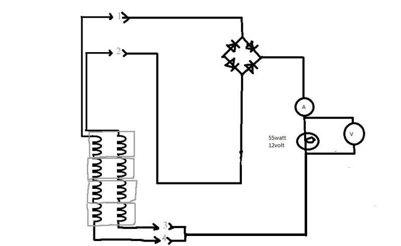

Postby DewCatTea-Bob » Thu Jun 16, 2011 9:00 pm
" Does it work better drawn in a circle, or in a straight row? (or one of each) ? "
____ I-myself can't cope with drawing things that aren't straight, so I've been working on a version showing the six spools in a straight-line. _ So it would be best for you Bruce, to do your version as you already have it, except instead of just leaving all your depicted coil-winding lead-ends merely extended & numbered, continue-onward & terminate them to terminal-points depicted in the very manor which Bill's drawing would have them. _ Cuz YOUR drawing shows which lead-ends go to which coil-windings, but not exactly how they turn-out arranged as they'd be actually seen by eye lined-up in their respective rows, as Bill shows the terminal-point/spots in his drawing.
__ Also, I have some opinions which you may (or may not) wish to adopt...
Both yours & Bill's drawings show the stator rotated 90-degrees from it's actual/normal position, (and both my modified-versions show this oversight corrected), so you may wish to adjust for that.
Another detail is I think that instead numbering each of the 24 lead-ends consecutively, they should instead be A1,A2/E1,E2 ; B1,B2/F1, F2 ; etc., (if you get what I mean).
And also, something I've wanted to suggest way-back since when you first gave letter-designations to each of the coil-windings (within the spools), is instead of naming them: "A" ; "B" ; "C" ; "D" / "E" ; "F" ; "G" ; "H" , they instead should've been called: 'A'; 'a' / 'B'; 'b' / 'C'; 'c' / 'D'; 'd' ,, where the cap.letters stand for the outer coil-windings, and the related-corresponding small-letters stand for the associated inner coil-windings (within same spool). _ (Which would lead to eliminating the confused array of letter-designations, as somewhat hap-hazardly assigned within your newer six dual-spool stator-drawing.)
__ That's my input for now.

Postby ecurbruce » Fri Jun 17, 2011 12:41 am
New drawing; if this works, we'll use it, if not we'll keep drawing...
Bill, do I have the odd rectangle with the correct coil set?
Bruce.
New Improved Stator-drawing! Still Needs Adjustment
Postby DewCatTea-Bob » Fri Jun 17, 2011 5:25 am
" New drawing; if this works, we'll use it, if not we'll keep drawing. "
____ You sure did get that all sorted-out & done fast !
____ Now what needs to be checked-through is if everyone agrees that the two related pic.drawings (now posted below), are in complete correlation/harmony...
I myself have now closely looked-over Bruce's newest stator-drawing and found it to be ALL logically well arranged, and so I began labeling all the terminal-points (which can be noticed if ya click twice on my posted version [of Bruce's pic]). _ I didn't finish labeling all 24 terminal-points because I then realized that Bruce's logical-arrangement did not directly correlate with Bill's-noted non-symmetrical connection-arrangement.
I HAD assumed that Bruce had patterned his depicted-drawing on an actual stator-example he's had in his possession, BUT now, I have to ask you -(Bruce), is your drawing (with it's shown 24 lead-ends particularly connected to all the 24 terminal-points) directly based on your known-knowledge of the stator, OR, merely based on just logical-guesswork on your-part ?

Bruce, the new drawing looks good and matches my stuff, other than that the inner/outer coils and inside/outside of each winding is still unknown on my stator so that could go either way.
Like Bob, I feel better looking at everything in a straight line but the circular arrangement has value also.

__ One thing which I need clarified first though, is exactly what test-setup/arrangement is referred-to by: "series/parallel" (in the last two groupings) ?
Like this one but 1-4 and 2-3 is A/B and C/D;

" Like this one but 1-4 and 2-3 is A/B and C/D; "
____ Okay Bill thanks ! _ I guess I can see why you called it "series/parallel" (but that makes for some confusion).
That's actually the old dual half-wave rectification arrangement, only now in combo with the 'straight-series' re-arrangement, (rather than Ducati's fore & back arrangement).
__ I'm glad that you-yourself thought to try-out this particular circuit-arrangement Bill, because while I certainly would've been interested in it's test-outcome, I wouldn't have wanted to be the one to push you into doing it.
__ Comparing this result-outcome to the previous equivalent version (with the stator-windings NOT in the straight-forward winding-fashion), should prove to be interesting.

Bob says" I HAD assumed that Bruce had patterned his depicted-drawing on an actual stator-example he's had in his possession, BUT now, I have to ask you -(Bruce), is your drawing (with it's shown 24 lead-ends particularly connected to all the 24 terminal-points) directly based on your known-knowledge of the stator, OR, merely based on just logical-guesswork on your-part ?"
I would have to say this drawing is more a logical arrangement meant to incorporate Bill's drawing into mine, and best used to organize schematic drawings in a logical manner. Looking at my stator, this doesn't match exactly how the leads are arranged literally, so as to be able to copy exactly from the drawing to the stator. To wire the stator is still going to take some continuity testing just to see where everything is going, but to depict it in the drawing the way it really is would further confuse things (logically) for schematic drawings. Bill had noted that there was one spool that was backwards or reversed and depicted such in his drawing, and I left that detail the way he had it.
Here is a version of drawing depicting the seperate sections I think the way you described.
