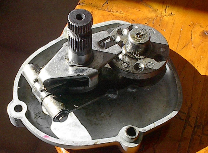

here is a small modification that makes assembling the selectorbox a whole lot easyer .
machine a groove for a circlip to hold the bridge in place that goes over the spring
and machine a small recess for the circlip in the cover
