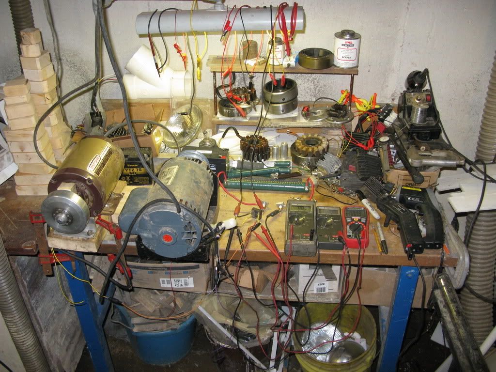

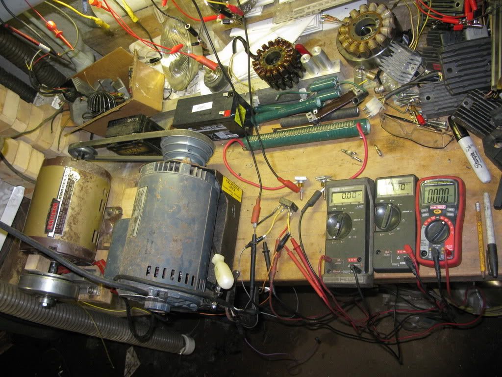

Ok, I'm back and open for business, ready for duty as test mule. I for one would welcome a fresh thread to start again in, go for it at your discretion.
And no, Bob, I have nothing really at stake here, my motor already has an adapted Nippon Denso setup fitted, though I plan to swap a few around at some point (more to play with rotor weight differences than anything).
To adapt the n-c stator to w-c is more of a bother than it's worth at this point, I'd like to get a 6 coil w-c stator to play with though. It seems so far there is no difference or issues in fitment to the engine/crank between the n-c and w-c rotors.
I'm putting up some pics so we can point to/refer to details more directly and descriptively, not so organized to be self explanatory but at least with consistently color coded wires on all but the meters.
I get .5 ohm across 1 and 3, .6 ohm across 2 and 4. No reading across 1and 2 or 3 and 4 (a meg ohm if I hold the leads on with my fingers
Here's the whole mickey mouse shootin' match:
Here's how I get 6k rpm, for 3450 I remove the belt and use the smaller motor directly;
The two original wires from the stator (1 and 2) are the black cord , with a black and a white conductor.
The added wires (3 and 4) are the yellow ones (one has a black stripe). (all coming out of the alternator at 8 o'clock and draped over the grey motor)
The other end of the black wire (through it's set of coils) is yellow/black, the white wire has the plain yellow at it's other end.
(since 1,2,3 and 4 aren't color coded on the drawing, the two pairs are interchangeable in my descriptions)
The black wire has a purple jumper connection,
the white has a grey jumper,
the yellow has yellow
and the black/yellow has orange.
