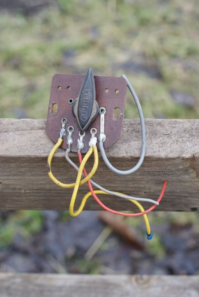

I've taken a few more detail shots of the various components I have (see below). In the case of the headlight, the previous pic showed basically everything there was to show internally (wire colours, positions and the various components) and I've now stripped it, so can't offer any better than that. There are some other components, but they're all separate from the bowl now, and they're all generic anyway, so have omitted them as well. The lights on the headlight bowl are 1 x red and 1 x green. Ignition barrel is still present: can you get/make keys for these? In the photo's I've seen of them they don't look overly complicated!

" I've taken a few more detail shots of the various components I have "
____ I've down-loaded all 12 pix and looked them over, and I can now confer with you about some things...
__ Very little of the wiring is stock and somebody has replaced much of it !
Did the person you got your 200-Duke from offer any knowledge about it's non-original electrical-system?
__ Did you remove the alternator from the motor yourself, or was it given to you along with the rest of the Duke (as a basket-case)?
I'm thinking that somewhere along-the-line, someone knew that (old) 200-models had alternators with the three wire-leads (colored Red; White; Yellow,, as on the old CEV-units), and perhaps (mistakenly) assumed that they had found a new/NOS example of the correct alt.model for the 200,, whereas actually, it seems you have the alt.model most used on 160-MonzaJr models.
__ Assuming that that's likely the case, it would be a bit of a shame to alter what may probably be a newer replacement-part, as there's no doubt someone who'd like to have that particular alt.model, (which is a pretty-neat work of wiring for it's intended purpose, [but not yours, as it is] ).
You can check to see if it's from an old/used pre-1969 Duke, or a newer replacement-part by looking-over the wiring...
If the White-wire is bright in color and seems quite pliable, then it's rather new,, but if that wire rather looks dirty-yellow and seems as if it'll crack if sharply bent, then it's very-old and should be replaced anyhow.
__ If you have an ohm-meter, then you could use it to comfirm the alt.stator-model.
