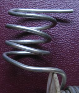

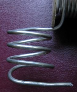

Since you obviously haven't made yourself a coil as I suggested...
Coil one way.
[/URL]Coil flipped the other way. Difference?
So where were we, previous to this sideshow?

__ Imagine a transparent clock on a glass-wall between two rooms,, as someone in one room sees the clock's hands turn clockwise, somebody in the other room will see the hands turn counter-clockwise !
Therefore the clock's hands, (and-also in relation to a winding on a coil), there's actually NO DIFFERENCE between 'clockwise' & 'counterclockwise' !! _ As from the clock's-OWN perspective -(the ONLY perspective that really counts !), it's hands obviously don't actually turn in an OPPOSITE-direction (from normal), simply depending upon the viewer's particular perspective !
So just like threads on a screw, the SET-direction does-NOT actually change, NO-matter HOW ya look at it !
" A length of wire, with electric current applied, has a ( field) around the length of it. When organized in a spiral fashion around an iron core, it organizes into a magnetic field with a negative and positive pole.
If you spin the wire on clockwise, north is at the top. It doesn't matter how that wire got on that core, as long as the current flows clockwise- the wire can start at the top, the bottom, in the middle, doesn't matter. It's the current flow, not the wind. "
____ ACTUALLY, it can equally be EITHER the direction that the current flows OR the direction of the WIND ! ...
The polarity-locations of the N.pole & S.pole not only depend on the direction that the DC.juice is connected to flow, but ALSO on whether the winding is right-hand or left-hand orientated !!
__ If you still have some wire leftover to wind-around a couple of suitably sized nails,, then with a battery connected, you could then easily prove that fact for yourself !
The green-statement seems plausible to me,, however the red-statement seems as if it MAY be indicating that the 'direction' of a winding makes no difference on the resulted polar-locations of the N & S poles. ...
While it's certainly true that all those listed aspects are-not relevant to polarization-orientation,, whether the winding starts-out going-to the right or the left, indeed IS relevant !
__ So rather than rack you brain any further with clock-perspectives,, prove the facts to yourself one way or another, by performing the child's-play of creating electro-magnets with wire-wrapped nails.
