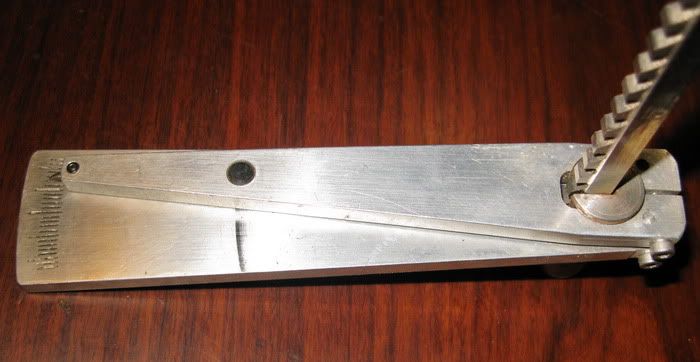

I reamed a 10mm hole in the center of a 6” square of 3/4” aluminum plate so the bearing block end of the cam could just rotate in it, I chucked a small 3” grinding wheel on a drill press and dressed it very square with the table. So with the ali plate sitting on the drill press table, the cam now sits exactly perpendicular to the wheel and the dp table can be moved up/down to line the wheel up with each lobe.
Now it was just a matter of locating the offending high areas and carefully grinding/blending them by pushing and rotating the cam into the wheel, the plate being able to slide around while still keeping the cam square. Did this very slowly, taking off few.0000”s then assembling the head and re assessing. Assembled/disassembled the head dozens of times, my fingers were sore from rotating the cam. The pins and cam bearing carrier started out pretty tight but I could work them in/out by hand by the time I was done. I used a sharpie (like Prussian blue) to coat the cam and rockers faces to find and eliminate points of partial contact and high/low spots. As I said earlier the worst areas that needed removal were thankfully small, a ¼” or so with another ¼” or so of blending on either side. I mostly split the difference from where I removed material between the opener and closer lobes.
After all that I only removed .002” of bind from the int and .003” ex, so I still have almost .002” of bind left on each. The real up side is I now have a very nice cam/rocker surface finish and good even contact so at this point I don’t want to push it and mess something up this late in the game. It gets very fussy at this point as the high spots now only cover a few degrees and if you ‘miss’ and grind a little off to one side, a low spot would be created and you can’t get it back or correct everything then without grinding most of the way around the lobe, I say no thanks to that...

You're pictured tool is one serious piece of kit - I've never seen one before, but what a brilliant idea!
