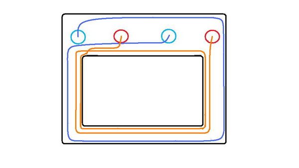

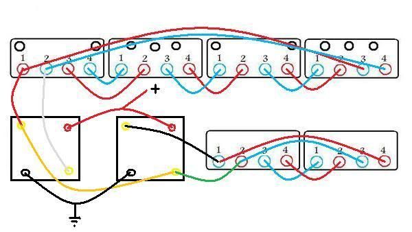

However, there's been some confusion concerning the actually varied location-points of the lead-ends not always being the same (as would normally be expected),, so the drawing (as I happen to have it), may possibly show some of the lead-end connections incorrectly-connected, to the wrong circuits.
__ For Bill's otherwise well drawn schemes to be properly comprehended, this raised-issue ought-to be elaborated.
I had been working on adding something to depict the windings (and direction of them) but was never satisfied with the results
so never got around to using any of them. In the old thread I has assumed we were all familiar enough with how things were
routed that there didn't seem to be an immediate need for it anyway.
It was all just work-in-progress at the time and nothing was 'finalized' as I naively though it would eventually be.
The physical arrangement of the wires coming out of the stock coils/bobbins is fairly consistent for
purposes of graphic rendition and with only one exception they all use the same basic order,
but just exit through different various holes.
The exception is the first large coil where the phasing is reversed from the other large one,
which is reflected in most of my drawings with the red/blue points being reversed.
That causes that particular parallel-from-hell drawing to have one error as the first 'block'
should have the connections reversed from all the others.
I had already noticed it but didn't bother with a correction because it still conveys the concept either way.
(one other that could possibly be considered an exception is the last coil where the last two 'grounded' wires exit through the same hole)
In both types of drawings I was/am using, there are two colors for the connections, red and blue.
Each color represents both a single continuous winding through the stator and also through the individual coils/bobbins (which have
their wires exiting in a staggered pattern, as do the drawings).
I don't think I ever was able to determine which were the actual inner/outer windings but only the phasing relative to each other.
This is a previously 'unpublished' alternate version that shows the the coils (and attempts to show phasing)
as well as correct routing on the first 'block'.

For an interesting puzzle, take a stab at figuring out the significance of the 'gold' wire/connection in this scheme.
It may lead to some understanding of the as yet inexplicable difference in outputs between the mosfet r/r and 'standard' ones.
Bruce should have particular interest at this time as it's very related to what's going on in this thread, both the beginning and present.
And I know it's always niggled at Bob, from way back...
For the pertinent details I'll only point to the the very end of the old thread, it's the very last thing I had ended with there.
viewtopic.php?f=3&t=556&hilit=alternator+modifications&start=350
- Posts: 318
Re: Troubleshooting Alternator Wiring
Bill says;"For an interesting puzzle, take a stab at figuring out the significance of the 'gold' wire/connection in this scheme."
Bill, do you know the answer to your question?
My uneducated guess is that it is bridging the two rec's and cutting the impedance in half, (as is done on an audio amplifier)???
Bruce
Bruce
No, I only know what I wrote about it in the link, basically that it has more output with that connection than without.
Not sure why/if it would reduce impedance but that could be an explanation if it indeed does.
