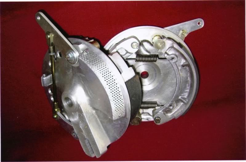

Also, I talked to David at Ducbits and he told me that 180mm 2LS is made to fit the ducati drum on most of our singles. it is a snug fit on the boss on the slider that keeps it from rotating. the reinforcing ribs that radiate out from the bearing on the hub need to be releived about 1/8th inch to clear the return springs. the plate has a functional scoop with a mesh screen over it and he describes it as having a racy look. He is sending me a picture. Said he is selling from his first run and the price is $400.00 the next run will be $500.

Dave from Ducbits sent me this photo. it is of the 180mm 2LS brake that with minor modification as mentioned in the preceeding post should fit our Dukes. I think it does look racy if a bit crude. those sharp edges could be rounded off easy enough.
Shown here are two brakes so that you can see the insides.

MotoMike wrote:Also, I talked to David at Ducbits and he told me that 180mm 2LS is made to fit the ducati drum on most of our singles. it is a snug fit on the boss on the slider that keeps it from rotating. the reinforcing ribs that radiate out from the bearing on the hub need to be releived about 1/8th inch to clear the return springs. the plate has a functional scoop with a mesh screen over it and he describes it as having a racy look. He is sending me a picture. Said he is selling from his first run and the price is $400.00 the next run will be $500.

these brakeplates are made by Budamotor in Hungary
http://www.budamotor.hu/
i am not impressed with their work
Jordan
Posts: 1508
Re: Looking to upgrade front brake
Postby Jordan » Sun Jun 26, 2011 12:11 am
Eldert wrote:these brakeplates are made by Budamotor in Hungary
Why not? It's not well-finished like Harleys, but if it works well?

I don't see the DucBits front brake on their site, but I do see the 2LS conversion for the 160MM rear Grimeca that I have see for sale on some sites.
Curious about the quality issue as well. :?:
