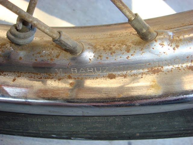

Also while taking everything apart to clean and inspect found this on the rims:

According to a few others on other sites those m-baruzzo torino wheels are really hard to find and were only used for a few years on the Mach1 and Mark3's, and the butted spokes are correct for just the Mark3's. According to http://www.coolitalianbikes.com's latest update which was specific to the wheels: "These Diana's featured chromed steel rims by M. Baruzzo, which are really hard to find, since they were not used on too many bikes. They are very narrow, 1.6 inch wide for 2.00-2.50 tires... The Diana 250 spokes are the "high performance" variety, 3.5mm at the ends and 3.0mm in the center of the shaft."

In the UK i would definately restore the bike to a Mach 1 spec, as this is the most sought after and valuable model, most of the difficult parts are now being remade, however the Mark 3 is the well known model in the US and I have period road tests showing raised bars ,black frame etc, so the choise is there, the M1 motor and M3 are to the same spec appart from generator and AAU is often to suit a battery-less system in the US.For ease of riding and starting I prefer the battery system.
