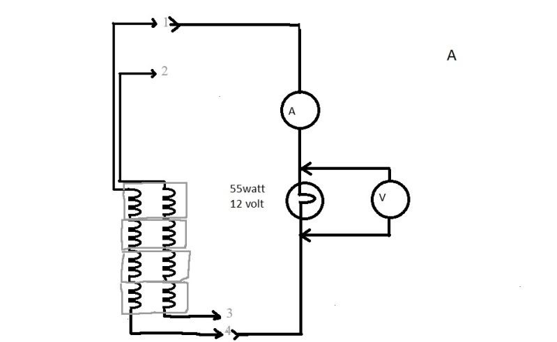

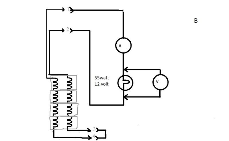

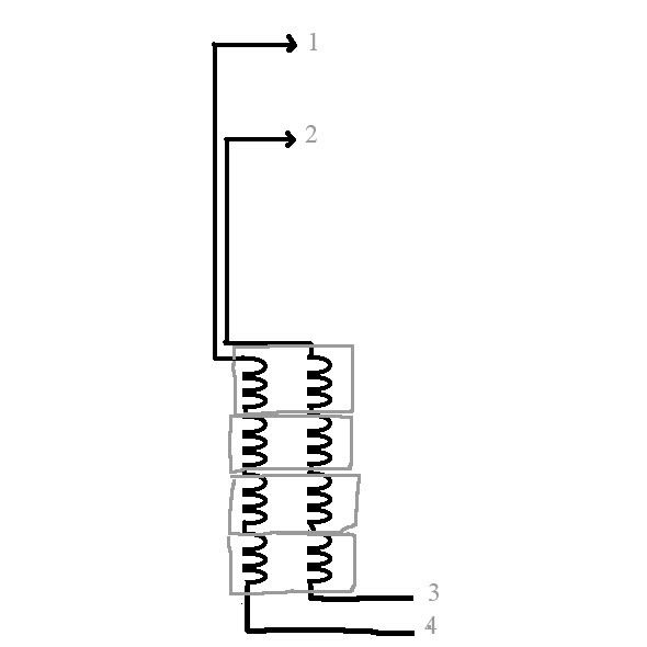

I did a quick 'n dirty edit of Mikes schematic, the concept is so basic I really don't feel it's needed but if it helps to keep things clear I figured it might have been worth the bother. Mike, I'm still not clear on what aspect of the testing connection descriptions are too vague to decipher...
I left it drawn 'unconnected' with the possible connections numbered only so as to be able to use it as a reference when trying to explain things. The grey boxes denote stator cores where the two separate windings share a common core.

probably just a way of speaking but current needs to be taken in series with the load, not across it.

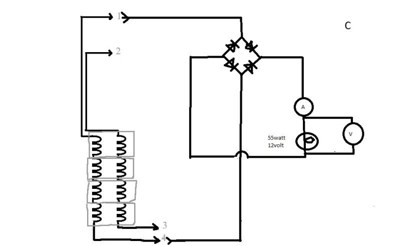

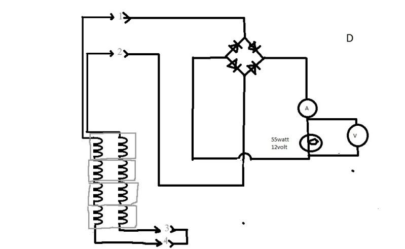

thanks for the drawing. I have reworked it yet again. I think it would probably be fine to test it at your initial rpm. and do all the configuration changes and checks with it at this intermediate rpm. Let me know if the following schematics labled A,B,C and D are the way you have connected the circuits. then we can go on and see what we have. As it pertains to checking the alternator output I think circuits A and B would be the way to go. after initial tests, you can put more bulbs in parallel with the original or use smaller or larger wattage rating bulbs to see if the alternator can handle it.

Yes, those drawings are correct. I've already provided data based on every one of the above drawings, as well as the addition of simultaneous vac readings with the vdc on the rectified circuits. If you need clarification as to what data correlates to what drawing, just point it out.

3450 rpm, load = 1ohm, 200w resistor, wired as per mikes drawing C; 6.5a, 9.8vac, 7.1vdc
6000 rpm, load = 1ohm, 200w resistor, wired as per mikes drawing C; 8.4a, 12.2vac, 9.2vdc
3450 rpm, load = 1ohm, 200w resistor, wired as per mikes drawing D; 4.9a, 7.9vac, 5.4vdc
6000 rpm, load = 1ohm, 200w resistor, wired as per mikes drawing C; 8.4a, 12.2vac, 9.2vdc "
____ So at the lower RPM, a single alt.winding provides about 64-watts of AC-power and about 46-watts in DC-power.
While at the higher RPM, the single alt.winding provides about 102-watts of AC-power and about 77-watts in DC-power.
" 3450 rpm, load = 1ohm, 200w resistor, wired as per mikes drawing D; 4.9a, 7.9vac, 5.4vdc "
____ And at the lower RPM with BOTH alt.windings (connected in series-fashion), the power-output is then about 39-watts of AC-power and about 26.5-watts of DC-power.
__ Now we have two main thoughts to ponder (since THIS "New data" doesn't directly correlate with your previous-data)...
One thought is that your new 'load' (vs. the bulb) is reflecting different current-flow characteristics,
another is you may've mistakenly connected #2 to #4 (instead of #3 to #4, as before), or simply miss-referenced Mike's 'C' & 'D' drawings. (?)
Do you have all-4 of your wire-leads all the same color (so that such a mix-up is more likely) ?
____ I sure hope you're okay with all the testing Bill, cuz more needs to be done ! _ So are you prepared for what's next (after your current/present figures are checked) ?
