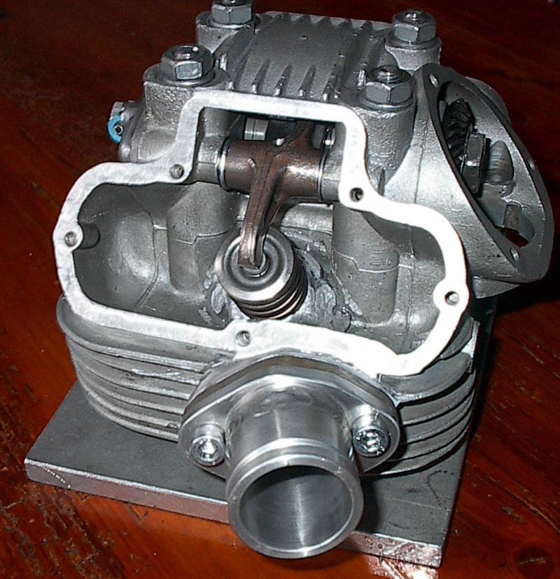

Some information relating to a "480" built some 10 years ago.
Although I have built many race engines over the years, at the time when I was doing most of this work, although I kept very detailed notes, I was not big on photographs as I was late to the digital world. On one of the 450 specials I built there was a rare occasion when I actually took pictures of the work but most of the time I was more interested in the results. This particular engine worked very well and at the moment it still holds the lap record for any Ducati Single for the Isle of Man mountain course. The work on this particular engine was done around ten years ago.
Basic specification:
Bore and stroke of 87mm x 80mm (476cc)
Compression ratio of 11.6:1
Desmo valve gear running with a Vee Two Cam
Valve sizes are 44mm inlet and 36mm exhaust with seat throats of 39.5mm and 32.4mm respectively.
Carb was a 38mm Amal smoothbore.
Maximum power was 47.9 bhp at about 7700rpm (at the back wheel).
Maximum torque being 36.6 ft/lb (torque was fairly flat between 4.5 to 7k)
The inlet port is 36mm at the flange and maintains an area of 36mm diameter throughout the port. The shape of this port changes to a kidney shape to maintain area around the guide. The head was cut and welded to allow this port area and the port is about 42mm wide at the guide, this would normally be well into the fins. The floor of the inlet tract was built up with weld and epoxy to provide a good radius at the floor of the port onto the seat. The heights of the ports have been raised and as can be seen from the pictures, the rocker chambers have been built up and the guides mounted as high as possible. The floor of the exhaust port was built up with weld to improve the radius from the seat to the floor of the port. Exhaust port diameter is 36mm which then steps into a 41.5 mm header pipe.
Unfortunately the view of the actual shape of the ports is distorted in the photos especially the inlet as it is down a long tract with a slight turn in it. For those of you wondering how the carb fits, the engine is not mounted in a standard frame, hence the more central port. The exhaust guide has been cut flush with the port roof which improved flow. This is not normally desirable as you lose contact area with the guide and expose more of the valve to the flame but with the guide mounted higher there was adequate length and contact. Bottom line is that it has never caused a problem in ten years! You will also notice that the combustion chamber has been relieved around the inlet valve as the semi hemi chamber masked the flow into the cylinder. I also spent some time on valve shapes and settled for a large radius underhead shape on the inlet valve which gave the best flow over the whole range of lifts.
The valve angle is standard as altering the valve angle on a Desmo gets complicated unless you are going to 60 degrees using modern rockers. As for the merits of using a 60 degree valve configuration, yes there are advantages in size of valve that can be used, but as the port entry is still in the same place, and you have to turn slightly sharper, with these and other limitations it’s slightly debatable whether you can take advantage of the larger valves with a suitable port. I have re-angled spring valve heads by a degree or so which was plenty to get in the valve sizes I required. Unfortunately I did not take any pictures of the valve spring engines! Needless to say the valve spring engines were just as quick as the Desmo and a lot less hassle. The limiting factor of the 450 Engine is the size of the ports and therefore the valve that can be used, ultimately limiting the revs at which maximum power can be achieved. Consequently with a maximum power below 8000 revs, the Desmo configuration has limited if any use.
I realised at the onset of the project that there was going to be a limitation in ultimate horsepower at higher revs so therefore I decided to stroke the engine for more capacity and planned on getting reasonable top end horsepower with a real good spread of power. With the various other similar engines I built I knew we were at odds with the modern Norton Manx’s but we were pleased to put up some respectable results. A good broad spread of power can make up for a lot on a short circuit and can annoy the hell out a modern Manx rider
I have attached a few pictures taken at the time. It was before I had a digital camera and the pictures were taken on film so apologies for the quality. I don’t feel that I am giving much away in secrets as the results are in the fine detail and it is one hell of a lot of work and if anyone wants to do it – good luck to them.
More photos to follow:

Pictures - cont'd

Would the Lacey 473 ports have been possible without employing desmo valve actuation? I don’t see adequate room for a valve spring. Desmo valve closure appears to be the only way to raise the valve guide that much. Did the valve spring engines that “were just as quick” employ this raised port design? If so, how were valve springs accommodated with the raised port? I’ve pondered this aspect of desmo valve actuation but never actually observed it employed to such advantage as in the Lacey head. Matt

Re: Singles Breathing
Hi,
The Desmo closing rocker is actually a hindrance to raising the guide. With a bit of jiggery pokery you can actually get the guide higher on the spring valve engine. My preferred method is to use hairsprings and special carriers allowing the springs to fit in a very tight space. This can be seen in the pictures below. I fortunately have an engine in for work, so I popped the inlet cover off to photograph it. This engine is from the bike owned by Harvey Ellis that Nigel Palmer rides. I built this engine some time ago for Harvey and have maintained it ever since. Harvey is a top guy and true enthusiast, he doesn’t ride himself, but has put a lot into the sport. Anybody in the European Classic racing scene will probably have seen this bike in action. It is 493cc, with a bore and stroke of 88 x 81mm.
It is possible to use coil springs with special deeper tops (just clearing the rocker), but space is a bit tight. Not revving beyond 8000 rpm our 3.8mm hairsprings have no problem keeping everything in check.
Hope this explains the spring valve verses desmo port size question.
Best Wishes Nigel
