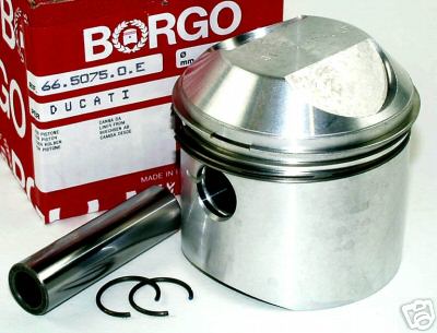

here is a pic of the 74 mm 10 to 1 Borgo piston
when measuring the combustionchamber with fluid and doing the math i never got 10 to 1
9.3 to 1 is what i landed up with
