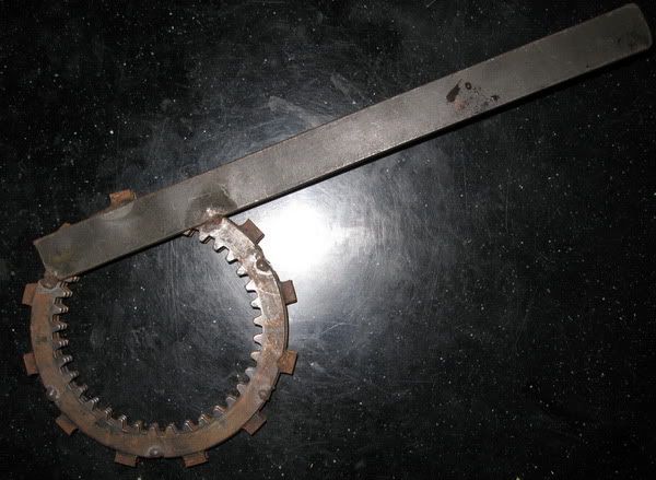

Is a clutch holding tool still available and if so from where?
I have old clutch plates and I seem to recall someone saying they fabricated a clutch-holding tool from old plates. I would do that if I could so I could add making the tool as a side bar to making the wiring repair.
Jim

On most any bike with a multi-plate clutch, a holding tool can be made by welding or bolting a few inner and outer plates together and then affix a handle of some sort in the same manor.

" Is a clutch holding tool still available and if so from where? "
____ I believe I once seen an eBay-seller in Aus. selling a newly-made version of one, if not, maybe 'bsanut' sells the like.
____ Back before I ever worked at any DUCATI-shop, I had found alternate methods (other than factory-tools) for doing anything needed to be done on the motor, (except for pulling the alt.rotor)...
__ For removal of the clutch-hub & drum, I'd engage the transmission (preferably into top-gear) and prop-lock the drive-sprocket (with a suitably-sized socket placed under a tooth), so as to hold the hub/main-shaft from turning (along with it's nut).
And also, to help take pressure off the transmission, I'd place a tightly wadded rag in-between the primary-gears' meshing teeth.
This dual-method works well enough, without any notable consequence.
In fact by itself, an already worn-out shop-rag folded-up tight in eight layers and tucked between the primary gear-set's meshing-teeth, will sufficiently lock-up that gear-set, all on it's own,, so that either nut (on crankshaft or main-shaft) can then be torqued-off (or on).
However for re-tightening those nuts back-down, I prefer the more fully solid feel of having the transmission locked-up in place as well (along-with the stuffed-rag method). _ Ya just pre-load the stuffed-rag resistance-pressure first, then place your chosen socket under the nearest tooth of the counter-shaft sprocket (to more solidly lock-up the transmission from turning along with the nut). _ This way, the locked in place main-shaft may then prevent the outermost layers of the rag from getting pinched-through & mashed-up (by the fully-meshing teeth).
__ Before bothering with locating a clutch-hub holder-tool, try this suggested method and see if it doesn't work quite well enough for you. _ If ya happen to have a small block of hard-wood (about the size of a 21 to 32mm socket), then that may work to adequately support/block the sprocket-tooth (instead of a [more handy] socket).
Of course (with top-gear engaged), this method can ALSO be done all on it's own (without the rag-method included). - (I-myself just don't believe in putting all my eggs in one basket, [if I don't have to].)
