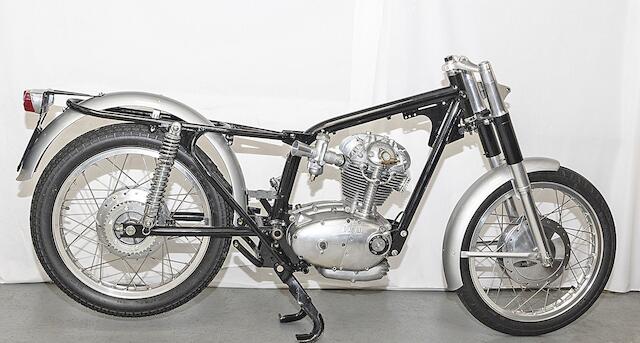

Here are the pictures from the auction catalogue:
The forks and top yoke are for handlebars, I'm thinking of fitting some low rise bars for a compromise between the high rise American bars, and clip-ons. This is a bike I intend to keep until I'm too old to ride anymore.

Hi Neville, Where abouts in the uk are you ?, I am in the south east . I have a Mark 3. There is a guy in the Uk that makes and sells good cheap machined parts, inc rear sets etc. The std cast footrests (not reasets, are easily found). Looks like you have all the most difficult stuff. If you are building a rider for yourself in old age then orriginality is not so relevant as comfort and practicality are king. I am 75 and intend to keep my 3 as its light and easy to push about. I am in the process of making it more practical.

The bike currently has a top yoke with handlebar clamps, but the headlight brackets are the shorter ones, with very nicely machined alloy spacers to cover where the clipons would mount, so I could go for either.

Looking at the standard of restoration it was pretty obvious that there just HAD to be a box of bits somewhere !. Exhaust pipes do seem to blue, but I think that preferable to the yellow that stainless goes.I don't think anyone is making the correct ( big outlet ) silencer that the Mach1 and Mark 3 need to run well.No reason a current offering could not be modified ,I use a Norton Cheroot silencer which nearly fits and is not restrictive, but a bit noisy !. Tank fixings can be vastly improved on , and need it. Barlecorn make some swan neck bars that would allow you to use your orriginal HL brackets and a smooth top yoke ,check the dimensions . My bike runs so much better with a remote float ( as supplied and fitted to some orriginal bikes ) . I will forward details of stainless supplier. Control perches and levers need to have the correct leverage ratio's if you are to avoid heavy clutch and poor brake. Fit an accessable grease nipple to the offside swinging arm.

We are all very interested in what it cost !!. It does look a really good job, but I have been "taken " a couple of times like that. I would definately take off the cam drive cover (with the RC drive ) and check the gears mesh with a tiny amount of freedom. Carefull with the RC alighinment on re-fitting.

Just checked the Auction., You did indeed get an absolute bargain . Possibly half to a third of its real value. Well done !!. The Bonhams description is a complete and utter load of twaddle . Its not a 1970, more like 1967 , The Description refers to the later widecase model that is very diferent. I suspect that the sellers only provided the Mark 3 reference and Bonhams assumed the rest !!. There is a date stamp on the inside of the fork leg which may help and I will check your engine no against my records .My guess is built 1966 and sold /registered 1967 or later. A very rare model that is mostly Mach 1 but with sensible kick start. Pretty much the bike that Won its class in the 67 24hr Barcelona Endurance race with Paul Smart and Reg Everett aboard . About 600 laps !.Designed to rev ,not slogged.
