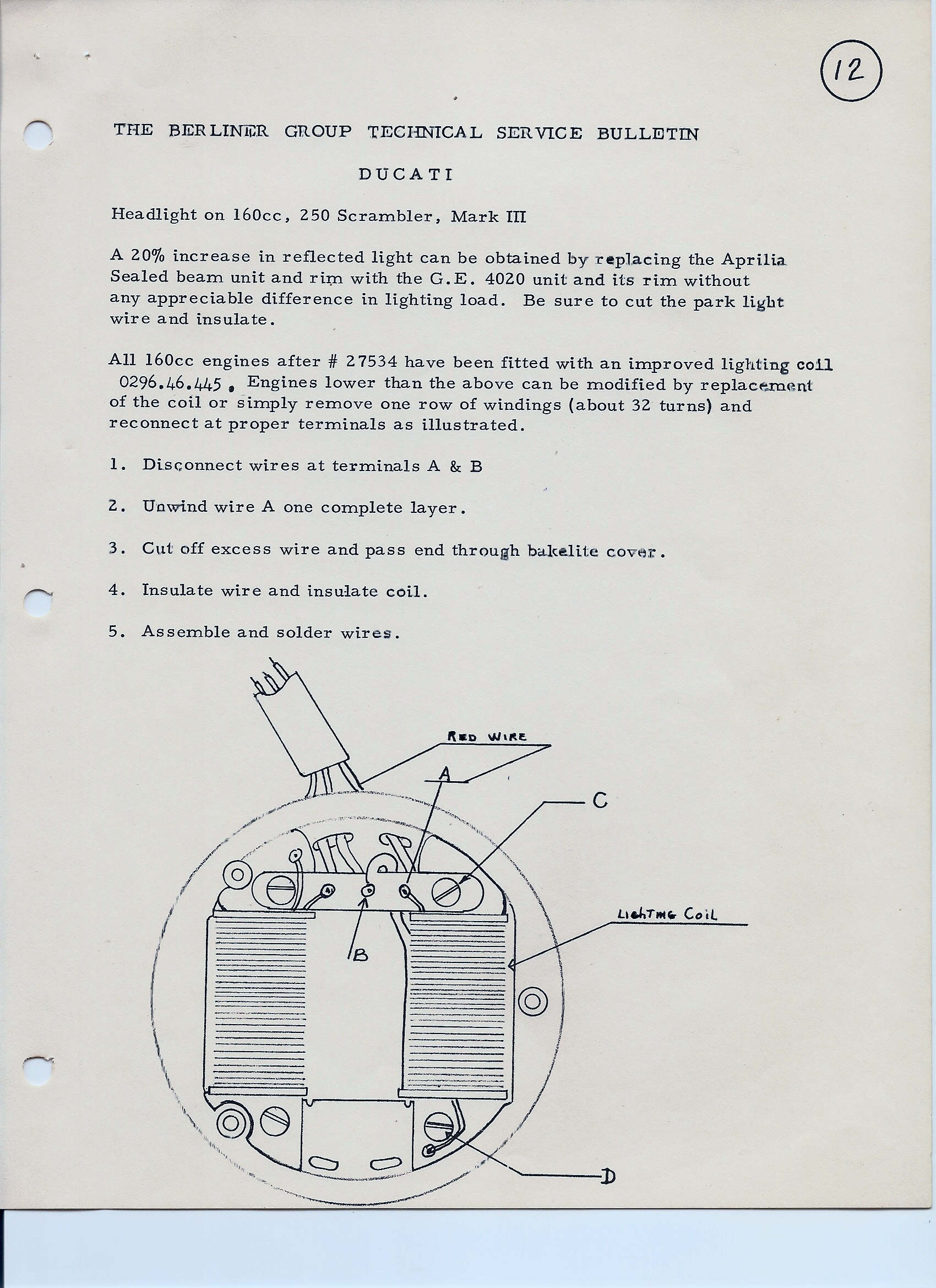

Here we see the sketch of a stator with the usual 3 output wires, but 2 internal ground connections of windings. It must contain a special winding scheme, as well as at least one coil in dual-layer fashion. OK, it should belong to n/c models, but your early SCR might have this type anyhow, so measuring 3 certain resistances against the stator is a matter of course in that case. I feel unable to answer your question about resistance values measured as long as we have not perfectly identified the type of stator in your bike. Let's unravel that mytery!

Zoomersmoto wrote:Is this colored markup of the magneto alternator correct for the 28 watt 6 volt Ducati Scrambler 250?
After scrutinizing the n/c workshop manual and other sources (see above) I conclude:
You posted the correct schematics for your bike (engine no. after 92171),
but the wrong picture for the alternator internals:
It belongs to the schematics for the early SCR (engine no. till 92171), ought to be associated with it:
Until eng. # 92171, a pure AC system was implemented, no battery, no stop light, separated AC ign. circuit. The wire colours might have been black, blue an unknown; those in the "at wits end .." post are different. the wires look quite new, like having been replaced.
Unfortunately, we do not have a sketch of the stator's inner circuitry. It's clear that your stator has no floating coil for lighting power, but indeed an inner ground connection, and two power outlets. We still do not know whether this "dual coil" is grounded on one end of the windings, or somewhere in between. This can possibly be found out by measuring the resistances and by tracking the output cables down to their solder spots/coil ends.

Well, I can't see any difference in colours when comparing yours and those in the other post
I understand that you scibbled the colours as depicted in the (correct) schematics of your loom onto the wrong stator schematics.
Now again: as long as we have no reference stator from somebody's stock, or your own at least visible in mounted position, we will not make any step further.
cheers and good luck Hans
