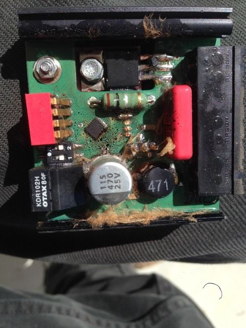

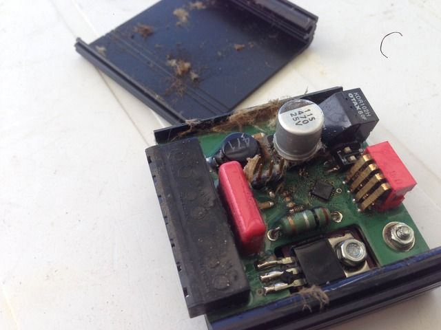

Last week during a ride the engine stopped and I found the black box had blown apart.
Any clues as to what might have caused this?
The RT has a scrambler alternater and SS regulator, 12 volt battery etc.
Coil is a Kawasaki 3 ohm and checks out ok.
The battery is a little low at just under 12 volts.
I would like to buy another black box but I would like to know why this one went bang and the smoke escaped?

I'm not familiar with the box you are talking about, but I am familiar with electronics.
Generally, the only component that has enough force, when it self destructs, to blow the box apart is an electrolytic capacitor. And most likely, if you look inside the box, it will be apparent what went poof. If there is a moist oily substance inside, that is almost certainly the capacitor that went.
Depending on what type of cap it was, reverse polarity will blow them. An internal short and high current will do the same. Find a HAM radio guy who is into the electronics, and he will probably be able to tell you what went by looking at it, but not necessarily why it went. Check all the external parameters. Battery voltage, regulated voltage, polarity, proper resistance of coils, no shorted wires, etc.

Hello Captain,
It's definitely a capacitor that went bang, I'll try and post some pictures.
I have sent an email and pictures to Sachse but as yet no reply.
I'd have to buy a new box from Sachse to get the RT going so I can test the reg but I'm hesitant to spend near $300 with the chance to blow another one if I can't find out what caused the smoke to escape.
Wiring, connectors, battery, and coil all look and test ok.

My best guess would be some sort of electrical feedback caused the e-cap to vent. The ZDG3 instalation manual leaves a lot to be desired in my book. Did you use a fuse on the power supply? Also the ground can be critical.
