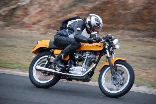

Giday Kev, stick with the Conti rep. its the best set-up for a road going 450. I have used that one on all the developments of my 450. It lets the exhaust system work to drop gas pressure and allow the sound waves to operate across a wide rpm range.
This is with a 32mm, and a alloy ram tube, with that exhaust, probably the best you can do with a standard engine.
This is with the full 456 engine, 41mm Malossi, V2 cam, and that same exhaust.
Harvey.

Postby graeme » Sat Jan 24, 2015 11:05 pm
I found that a Conti type works the best also.
This engine with standard desmo cam, 42mm inlet, standard exhaust valve, 87mm piston and a 36mm carb.
Tried 40mm but too big for a (this) engine.

Postby Dave450 » Sun Jan 25, 2015 1:06 am
Yes, a Conti is the way to go with a street 450. This is with a 40mm, race cam, 42 mm inlet, std exhaust. It gives a nice spread of power in the mid-range - great for the road. You will sacrifice top end a bit, but I don't know of any underslung road silencer that doesn't. I haven't tried a Supertrapp, though. Has anyone else?
Nice pic of you, Graeme! And Silver Shotgun looks good, too.
