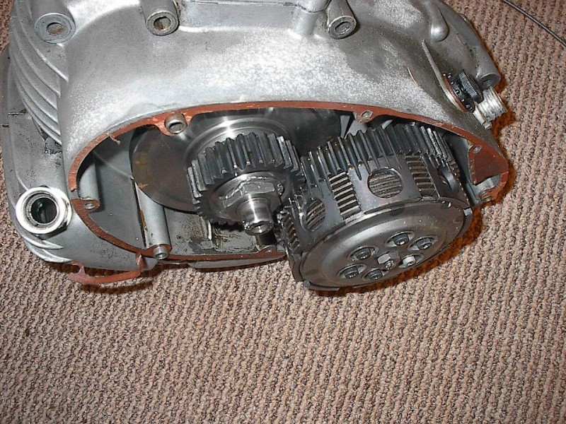

Postby Eldert » Sat Oct 18, 2014 7:31 pm
the straight cut primary gears look like aftermarked to me .

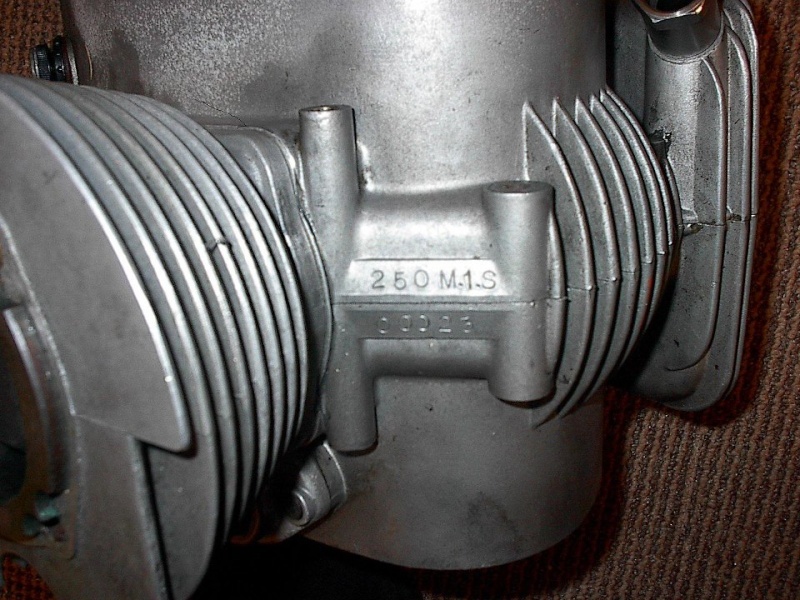

this is what i found inside 250 M1S nr 23 :

" the straight cut primary gears look like aftermarked to me . "
____ Well Eldert, you certainly know more about these primary-sets than I do ! _ But what aftermarket-maker in the-world would've ever bothered to independently produce such primary-gear sets for Ducati's 250-motors ??
" this is what i found inside 250 M1S nr 23 : "
____ So how many teeth are on each of the gears of your straight-cut primary-set ?
____ Thanks for the posted-pix of your extremely rare M.1.S motor,
it's a certain privilege to have seen !
Enlightened-Cheers,
Posts: 837
Re: Race Clutch and piston.
Postby Eldert » Sun Oct 19, 2014 10:50 am
Hi Bob
this engine is not mine . did not count the teeth on the clutch . just had enough time to make a couple pictures before it got shipped to Japan .

Eldert and Bob, it certainly looks similar but is not the same size. The primary must be bigger and clutch basket smaller as you can see where the gear pattern is cut into the basket ears. One thing I'm loving about Ducati single ownership is the amount of experience out there that people such as yourselves are willing to share!
