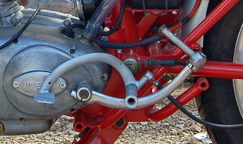

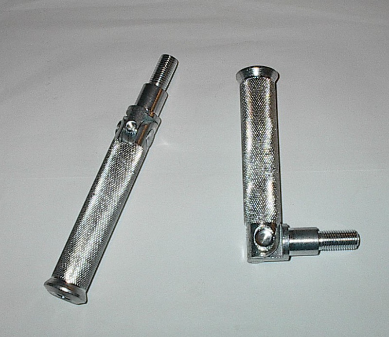

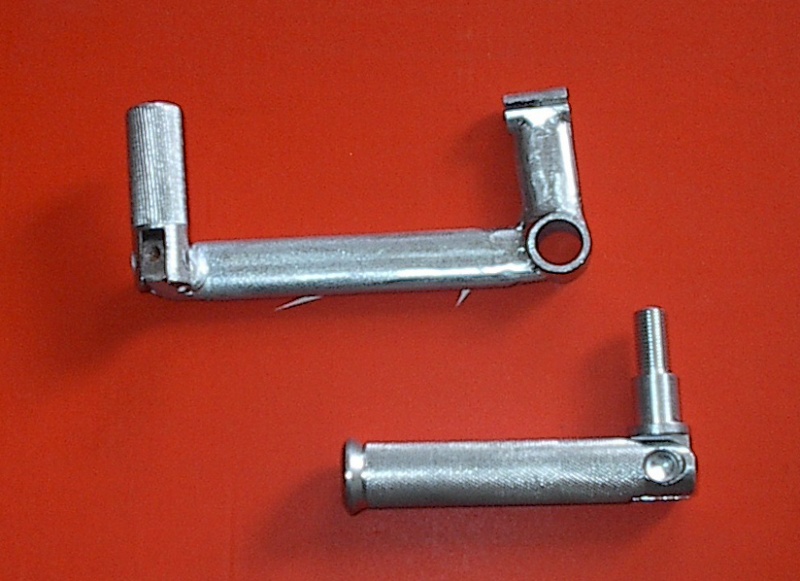

Trying to convert to racing kit on the Mark III. I have a reproduction set of curved brake pedal and curved kickstarter and shifter. Does anyone know what the original footpegs looked like in turns of finish and foldablity. Did their both fold? or just the left side to allow use of the kickstarter. Anyone sell these?

On the oem footpegs only the left side folded... As long as he still has some available, Eldert can sell you either a set of folding pegs, or one folding and one fixed... These are reproduction and are nice (and so much cheaper than oem pegs which are nearly impossible to find) There are some coming out of thailand also but they look pretty rough to me...Try Eldert first (on this site) if he doesnt have any i can send you the contact info of a guy in the u.k. that also makes them.

plenty of folding and non folding footrests left to sell . the finish is zinc plated
here a picture of a original Mach 1 setup . hard to tell if the footrest is a folding one or not
and here some pictures of what i have
i had the folding rearbrake pedal ( silver Desmo type ) made to
