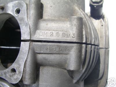

The engine number prefix is DM250 rather than DM250M3. It is unclear to me from my reading if the early Diana's exported to the US had the M3 notation (from my reading it may be that this didn't happen until the release of the Mach 1 and it's M1 notification - but it isn't clear). How do these numbers sit with it being an original 64 Mark 3? (EDIT: It's not even clear to me from my reading when the "Mark 3" name became "official") To be clear, the purpose of the question is merely intellectual interest and education.

" The engine number prefix is DM250 rather than DM250M3. It is unclear to me from my reading if the early Diana's exported to the US had the M3 notation "
____ I'm quite certain that the suffix 'M3' was not included on any 'Diana Mark III' motor before the '250Mach I' model went into production for the 1965 model-year.

this bike is fitted with a 4 speed engine . i thought that a 1964 should be fitted with a 5 speed engine
anyway i never seen a 4 speed crankcase stamped DM 250 M3 .
and...
Hi Eldert, how did you arrive at that 4 gear assessment. Is that by engine number? I discussed with the owner before posting my initial post that this bike may be one of the initial exports that actually led to Berliner's "Mark III" title....ie it was a Diana with a race kit but predated the Mach 1 and '64 5 gear models. The other thing that points me towards that is the tail light. IS there anything to be learned from the (poorly focussed) shot of the underside of the tank? The tunnels underneath are non symetrical with a larger tunnel over the carb side.

Hi Kev
DM 250 suffix on rh crankcase is 4 speed . 5 speeders had the DM 250 on the lh crankcase
