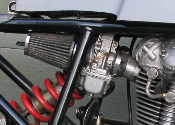

As you who have been following my Mikuni jetting thread and my "ankle buster" thread know, I have been trying to resolve a 6000 RPM artificial rev limit and a over-rich mixture which may or may not be related to each other.
While I play with jetting to cure the too rich condition and while I also try a HV coil swap to see if that impacts the rev limit as part of a comprehensive process of elimination, I just want to ping the experts/racers here regarding the possibility that the (and I am not sure I have the terminology correct) intake tract length, that is to say the distance from the carb outlet to the cylinder head manifold could be creating the artificial rev limit and/or the over rich condition.
The carb is connected to the manifold by means of a rubber hose that is about 2" (50mm) long.
I have not as yet looked at the manifold to understand why the carb outlet is not directly attached to the manifold but I expect that it would have been if not for some mechanical impediment between the manifold and the carb body .
Would increasing the intake tract length:
a)adversely affect the quantity of fuel mixture entering the cylinder head at higher RPMs causing the engine to sputter (not sure if it's starved for fuel or beginning to foul the plug at this point.)
or
b) create an overly rich condition? I know there is a whole science of fuel/air mixture associated with the tract length, the cylinder's volume, the exhaust stroke and valve timing etc.
Jim

While the length can have some effect, it would be very small/subtle and nothing remotely on the scale of what you're experiencing.
Since the mikuni's use a spigot as an attachment method, the type of manifold adaptation on your motor is pretty typical. It can be an advantage over a straight bolt up arrangement (like with the amal's) as it provides isolation for the carb from heat transfer and vibration. It also allows for some latitude on location and placement angle.
If you wanted a shorter/cleaner looking arrangement, while still retaining the isolation benefits, there are molded rubber adapters available that have a two bolt flange and spigot all-in-one but not sure if there are any with the right size combination for your setup. I used one for the TM mikuni on my 450 but had to make an adapter to alter the mounting angle a bit.

Jim,
I have experimented with both 2 stroke and four stroke (yes a Mikuni is designed for both) and changing the intake distance a little doesn't seem to make any difference. Mine is butted up against the intake and connected with a rubber hose exactly like yours. I don't have a tach so I can't say what it runs like at 6000 rpm's but it runs and sounds good all the way to max rpm's. You might want to check the low speed jet. I know that if I change the size of the low speed jet I will have to make needle adjustments. If you haven't already cleaned the carb good you might want to try that before swapping carbs. The difference between a modern Mikuni and the old Dellorto or Amal or any other factory carb is evident the first time you crank the motor.
Now I know all the purists will tear me apart for that statement but all I know is they work on my Montesa, my Vincent, my Yamaha and soon on my Goldstar. Experience is my only expertise

190 main, 22.5 pilot, 00 needle, 5E75 jet needle, 1.50 cutaway on the slide (previously posted in Where to buy Mikuni Jets). And yes Bob I meant they make carburetors for both. Mine is for a four stroke and the main jet/atomizer is smooth with inlet bore (not protruding). Something to check though Jim if you take it apart.
