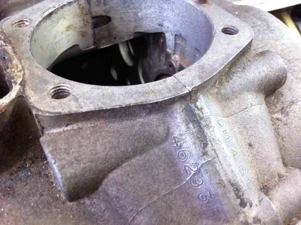

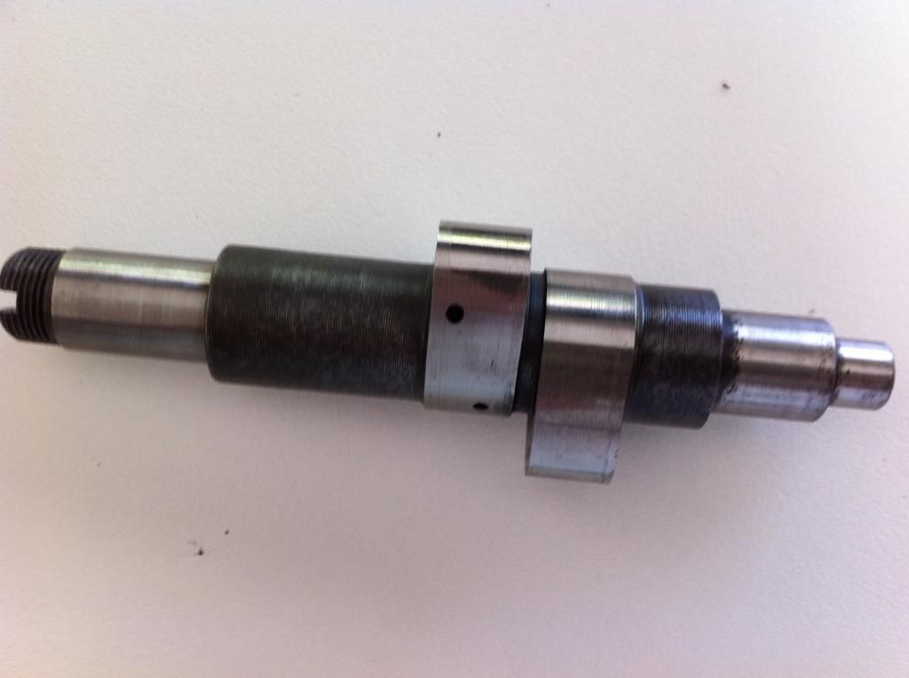

The 450 Scrambler cam I have came with a 450 engine which was in several boxes so I can't say if it is the cam that was in the head when it left the factory?
The cases didn't match either, the right side is a late wide cylinder bolt half and the right is an earlier narrow bolt model.
So I don't describe this "wide bolt" statement incorrectly, the bolts forward and rear of the cylinder hole. picture below,

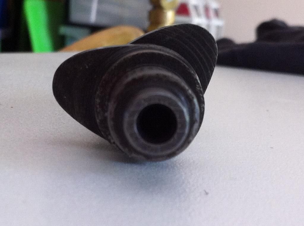

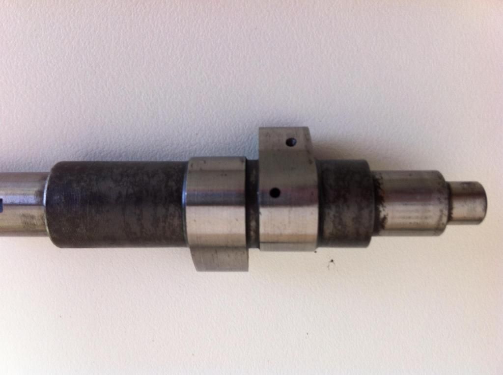

The cam measures 21.8mm at the base circle and both lobes measure 30mm. There are 2 oil holes in each lobe.

" The 450 Scrambler cam I have came with a 450 engine which was in several boxes so I can't say if it is the cam that was in the head when it left the factory? "
____ Okay then, that was certainly fair enough reasoning, (being an aspect I was unaware of),, however in that case, how could you then be any at all sure of WHAT-ever Duke-model the spare-cam may have actually come from !?
Oh-well, in any case,, it now seems certain that it was a GOOD presumption that the spare-cam actually originally came from a 450-model, (although likely not a REAL '450Scr.cam-model').
__ Anyhow, since you're STILL stating: "450 Scrambler cam", I thus-then feel the need to restate my point once again, that while such a 450Scr.cam-model really exist, it unfortunately did-NOT come stock within any 450-Scrambler imported into the U.S.A (at least).
I've already fairly well explained why no-one should refer to a 450-springer model's stock-cam, (which had originally came within a stock [non DESMO] 450-model), as a '450-Scrambler cam-model'.
If my previously posted-wording failed to make my (rather disconcerting) point perfectly clear, to ANYone,, then please ask for further clarification.
" The cases didn't match either, the right side is a late wide cylinder bolt half and the right is an earlier narrow bolt model. "
____ Boy-O-boy, SOMEone sure was desperate to scrap-together a 450 bottom-end !
I would've advised against such a mismatch of motor-case halves.
" The cam measures 21.8mm at the base circle and both lobes measure 30mm. "
____ I never recall min.base-circle or max.base-circle&lobe figures of any cam.model, since those figures can vary somewhat for any particular cam.model, (while the 'difference' between those two measured-figures always yields a particular cam.model's intended amount of lobe-lift).
__ I'm inclined to believe that you've likely obtained the correct b-c.+lobe figure of "30mm", however your other figure of "21.8mm" for the minimum 'base-circle' is suspect because it indicates that the lobe-lift of BOTH of the cam-lobes is identical at 8.2mm,, and,but the exhaust-lobe is always at least .2mm shorter than the intake-lobe.
So therefore I'm suspecting that you may-likely have measured at least one of the individual base-circles of the two separate cam-track/faces, incorrectly somehow.
Also,, when taking the cam-lobe's max.overall-measurement, it's worn track-face area should be avoided, and the usually near 1mm-wide unworn-area (at the edge of the peak of the lobe), is where your micrometer should get it's reading taken-from,, so as to better help identify the specific cam.model.
" I'll see if I can get the cam bearing holder off easily and get some idea of what cam is in that engine. "
____ After removing the four 6mm Allen-screws from the cam-bearing support/cover, then try using a long/thin rod in-through the center of the right-side/end of the camshaft, to then next tap on it until that cover has been pushed-out nearly an inch, and then twist the cover by hand to extract it outward the rest of the way (from it's place in the head).
____ I have adjusted your pix of your camshaft in question, and inserted them below along-with associated comments included.
__ After you've confirmed that you've correctly measured the absolute-MINIMUM 'min.base-circle' diameter of EACH of the two cam-tracks, then we will use your latest measurement-figures to confirm the specific cam.model of your presented camshaft.
