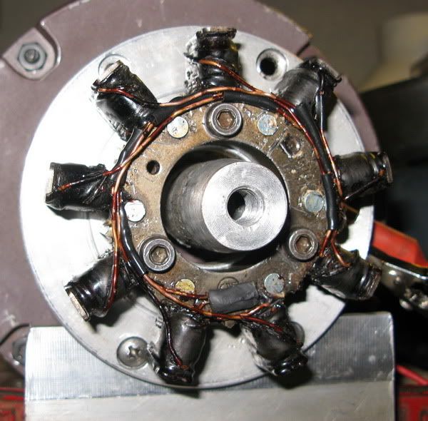

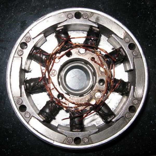

I've modded another couple 3-ph stators, one early 80's Kawi 18 coil and one early 2k's GSXR 18 coil, both use 12 pole rotors.
The Kawi was lower output as it's physically smaller and it's older rotor has less potent magnets, so I only removed half (9) of the coils/cores, while on the GSXR I removed
two thirds (12) of them as its larger and it's rotor has killer strong magnets. The resulting (GSXR) 6 coil is arranged in three coil pairs in another odd looking pattern of two pairs at 60 degrees apart and one pair at 180 apart. The 9 coil is a more straightforward setup with three sets of three coils in a linear triangular pattern with 80 degrees separating them.
Both are wired in the star configuration for now.
Output was surprisingly close on both, breakeven was in the low 2000's, not as good as the zx14 setup but slightly better than the 3 sec stock setup. Haven't setup to test for max output wattage but they both did low 90's at 2760 rpm with the currently standard bike simulation setup and an additional 4 ohm load. Temps stayed acceptably cool staying below 20 degrees over ambient.
I thought I had finally found a 3-ph combo (the 9 coil stator) that would work using the stock 6 pole rotor but was again disappointed, it did work but the output was underwhelming, putting out only about a third of the wattage of the stock modded stator under the same test conditions. As with the 18 coil stator, I still blame it on the magnets being too wide, causing excessive overlap on the different coil sets (?).
That pretty much finishes up the possibilities for 3-ph mods for the hardware I have on hand so it's finally time to move on, I've been composing a somewhat extensive commentary
