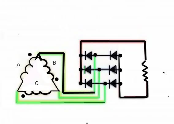

The Delta is a difficult system to get your mind around I will give you that. I don't think I have divined all it's secrets, but have just analyzed it enough to say it works well for high current applications in a three-phase circuit. Delta is fairly commonly used in industry for it's ability to produce more current than an equivalently sized y winding scheme. No diodes are needed to make it work as a three phase source. If you want to try to flow current through it here is a schematic, I think I can talk you through it. If anyone wants to do it themselves, I recommend marking the polarity on the coils every 60 degrees starting at zero. In this way you will always catch one coil as its induced voltage is zero, and in this way not have to consider it when trying to flow current.

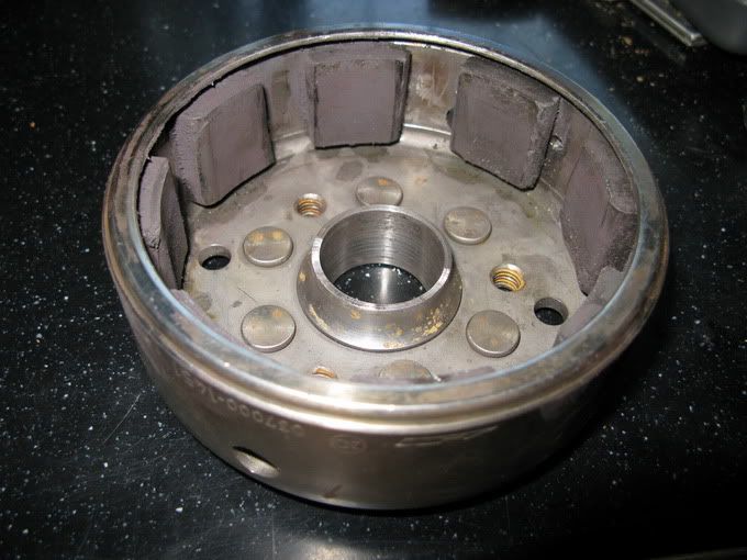

Curiosity got the best of me and I went ahead and put together an 8 pole rotor out of the modded 12 pole one I had dissected, a bit mickey mouse but fine for testing. If I were to use it in my 450 motor I think completely potting the magnets in flush with epoxy would be a pretty permanent and useable solution.
The stator was a pretty easy rewire from the three section setup, I left the 6 external connections so it's possible to switch from 'star' to 'delta' configurations. Unfortunately the single phase three section config doesn't work with the 8 pole so really direct apples/apples comparison isn't possible as the number and type of magnets are different from the 6 pole. I'm guessing that if I had wider magnets on the 8 pole rotor that

The two configurations start off virtually the same but as the load increases delta has a distinct advantage, as it's supposed to. Could be due to it's theoretical lower working impedance. The star should have a voltage advantage at lower rpm that isn't evidenced at 4310 or 3450 rpm, I'd like to try it at a much lower rev to see but not sure I want to take the time to set that up...

You are definatly the man. Never let it be said it can't be done. I had my doubts you'd get the magnets aligned right, but you must have. I'm wondering how close the magnest are to the core compared to the originals. I think your numbers are impressive as there is no way those magnets are as effectively coupling the field through the cores as the original does with it's laminate bridge between the magnets getting very close to the cores.
