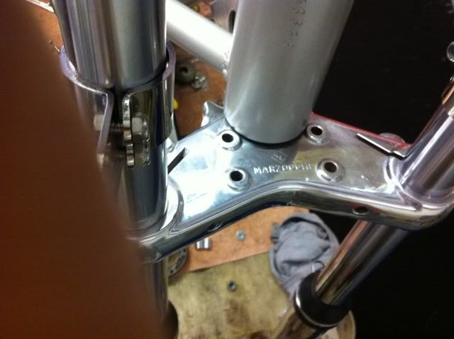

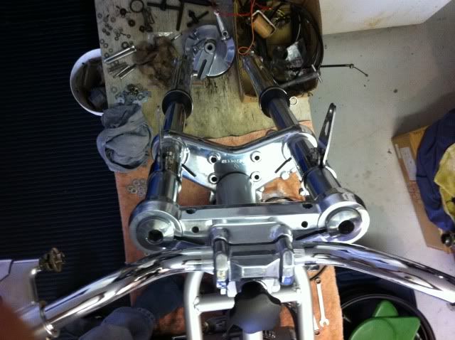

Re: RT Rebuild and questions
Eldert, may I ask you to measure the thickness of your bottom triple clamp please.
Mine is 32mm thick, plus 22mm for the alloy spacers is 54mm plus the bracket and washers and the lylock nut, the bolts would need to be close to 70mm long not 45mm??????
I wouldn't be surprised if the triple clamp on this RT isn't original.
Regards
Graeme
Regards
Graeme

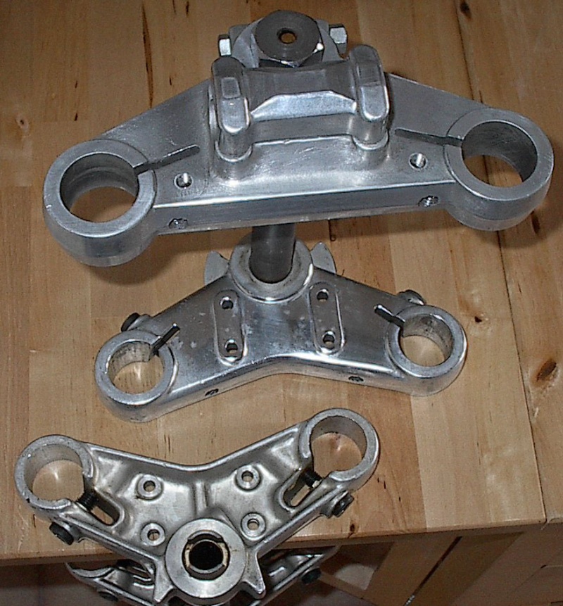

- Posts: 837
Hi Graeme
on my tripple clamp the bolts go only 13 mm thru
here is a picture of a RT tripple clamp set
- Posts: 1062
The top looks the same, the lower looks the same, except the underside of the 4 holes is built up compared to yours.
The rest looks the same
I will reduce the spacers.
How far is the guard bracket away from the underside of the triple clamp?
If your holes are 13mm plus 22mm spacers, = 35mm from the top of the lower clamp? (about 3mm spacers in my case)
Regards
Graeme

- Posts: 837
Hi Graeme
i dont have time to measure today ( workshop not at home ) but with 3 mm spacers everything should be fine

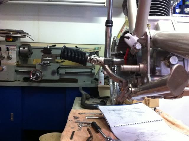

Sorry, next question,
Is this footpeg bracket bent or are they supposed to be on and upward angle like this?
It would take a lot of force to bend the cast steel bracket I would think. And a fair bit of heat to straighten it.
The right side is up but not this much.
- Posts: 837
Hi Greame
on both my RTs the footrest are straight . your footrests look like Scrambler items to me
a RT footrest is round metal with a little plate welded on top
- Posts: 1062
Hello Eldert,
The parts manual shows the foot pegs as you have described and the round type I have but without the round rubber that came with my US RT.
I bought new rubbers to fit to the round pegs, part number 170 for left and right.
The flat type shows part no. 285 left and 185 right.
Another case of what was on the parts shelf is what was fitted?
But you said they were level which is what I needed to know, thanks.
Regards
Graeme
