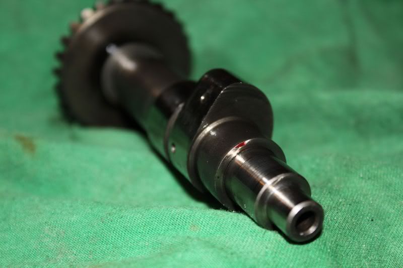

Here's a picture of the camshaft showing the red paint dab:

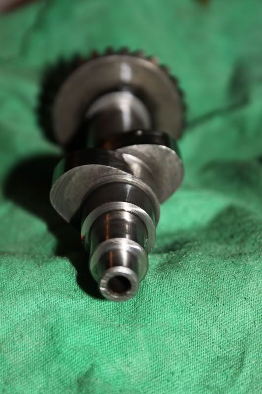

Here's a picture of the camshaft showing the lobe profiles:

Top-end Parts Identification
" Here's a picture of the camshaft showing the red paint dab: "
____ That's not where the factory-placed identifying paint-color is located on the camshaft !
I have no idea what that red-stuff is doing (where it is) on your cam, (as it shouldn't be there!).
__ Do you have a pic showing the shaft-end where the threads are ?
" Here's a picture of the camshaft showing the lobe profiles: "
____ It's not easy to be certain but, that appears to be the gray-cam (rather than the red-cam).
