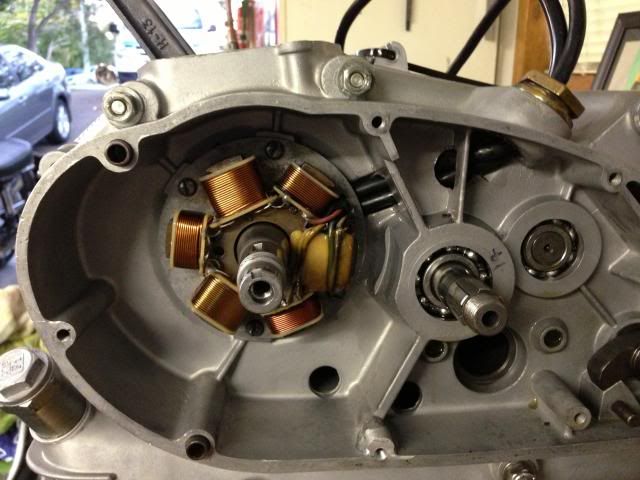

The later 450's (and I assume the 350 and 250?) use these alternators.
I assume they deliver the same wattage as the points widecase scramblers but with only 5 coils ? Is that correct?
If so the 5 windings must be different to the normal 6 coils. Perhaps test what these windings deliver and copy that to 6 coils to get more wattage?
Graeme
(should I go back in the corner?
Graeme
450 Allt.stators with Electronic-ignition
[quote= graeme ...
" I assume they deliver the same wattage as the points widecase scramblers but with only 5 coils ? "
____ I wouldn't assume that,, the claimed 70-watts for the 6 power-coil 450-alt.system is likely under-RATED to begin with, so-thus your 450's 5 power-coil alt.system is still good for the 70-watt rating.
" If so the 5 windings must be different to the normal 6 coils. "
____ I don't really know for sure but, I'd bet that they are just the same as all the other 6-pole type power-windings.
" Perhaps test what these windings deliver and copy that to 6 coils to get more wattage?
(should I go back in the corner? "
____ All Ideas are welcome, of-course,, but I'm fairly doubtful that those main-type power-coils deliver any more power than any of the others like them.
However the one coil that's dedicated to powering the ign.system, quite more-likely has differently intended output characteristics (which would be interesting to test !).

The ignition coil on Graeme's later single is for the CDI system, that generates about 350 Volts.
Harvey.

So from having kicked-around these somewhat confirming figures, it now SEEMS that the impedance-factor increases at about a ratio of 1.5:1 as winding-length increases. _ In other-words, for instance,, a power-winding that's doubled in length doesn't merely have just twice the impedance-total, but rather 3-times as much. - For example, if two large-coils were connected in series, their 7 + 7 (individual impedance-values) wouldn't total-up to just 14-ohms, but-RATHER up-to a 21-ohm impedance-total.
__ Now I admit that this deduction is based upon shaky-ground, so we need to check-further for other confirming (or contradictory) figures,, so lets all keep our eyes-open for such ! _ Because most who are following this thread ought-to understand that power-winding impedance is an UNWANTED factor ! - (Cuz it causes the power-winding to become more of a 'bottle-neck' [and thusly reduces power-transfer to the intended-load]!)
____ A cap can only store any-leftover power that the load had failed to consume from the pulsed-DC, and-then deliver it between the DC.pulses,, thus-then keeping the filament maintained at a hotter-temp, (as cooler filaments consume power-juice at a FASTER rate !). _ So it makes some sense that your caps cause the light to become brighter ! ...And quite consistently improve output, always makes that headlight brighter. And before you start... I don't care by what means, it's not some trickery.
If your chosen cap.capacity were to be too-small, or if you tried powering more than one (such powerful) headlight,, THEN the inclusion of the caps would make NO such beneficial improvement !
____ Doing that test regularly, may be of relative importance...Something that might be of interest,, is to see just how high the voltage can possibly become, with a cap & NO load (at the near 3500-RPM).
53vdc
__ Since the preferred method of determining power-coil strength is so difficult to dial-into precisely, we may find that performing this test could likely yield a more-accurate test-result for comparing the relative strength of various power-windings. _ As the very-high (and rather consistent) resistance of the volt-meter will allow rather precise measurement of a power-winding's max.tension, which I'm sure is linearly related to max.power. _ But-however of-course, max.power can only be determined by dialing-in a test-load value that's precisely matched to whatever the actual impedance of the power-coil is,, and Bill has made it fairly apparent that attempting to dial-in test-loads into fractions of an ohm (to find the optimum load-value), is way-far more too-tedious to get accurately tested !
__ So providing that I'm not proven wrong about this max.voltage measurement being straight-forwardly linearly equal to max.power,, then with such test-measuring, it ought-to be rather easy to calculate max.power, rather than actually performing all the tedious/taskful work of attempting to 'measure' whatever it actually is.
____ So as a baseline, we need to discover whatever the 'max.voltage' is of stock power-coils,, and also, that of some power-winding example which Bill was able to precisely dial-in the max.power rating of.
__ Does this reasoning not make fairly good sense to you guys ?

What seems to be amiss ?
Anyhow,, is your method for measuring weight capable of measuring the weight of the removed winding-layer, down-to fractions of a gram ?
__ Of-course it makes logical-sense that the max.power has fallen-down with the shortened power-winding (being just 9, instead of 10 layers),, but I have no explanation for why the power-drop wasn't all flat across-the-board AND that there was an actual 21% INCREASE at the lowest test-load. _ I can only guess that either perhaps Bruce's concern about the outermost layers being too far-away from the concentrated mag.field, or, perhaps too-far from the core and/or too-close to the stator-plate,, has allowed THAT outer-layer's ratio of power-production vs. impedance to become less productive (than the inner-layers are).
" Seems predictable where the results of removing another layer will go
, so I stopped here. "
____ Considering the measured inconsistencies, I-myself really can't see where it's very predictable at all !
__ We need to compare the weight of the removed-layer to that of the remaining-layers, so-as to get an idea of how much more of the power-winding has to be removed to get the large-coil to be matched with the small-coil.
__ Did you measure the weight of the large-coil before you removed it's outer-layer ?
How does the large-coil's weight now compare to the small-coil's, presently ?
__ It would also be useful to know what the NO-load max.voltage is from this stock power-coil, as well !
Max.power ought-to be close to the same-amount, regardless whether in series or parallel, (providing that the two separate power-windings are 'matched'). _ Unless one of the two windings was somehow left offline, the fact that the max.power was ONLY about half that of the series-arrangement, means that the longer/outer-winding saw the shorter/inner-winding as a 'load' (more-so than a helping-buddy), and-so the parallel-combined power-winding was robbed before it's combined-output could get-to the test-load. _ However, I wouldn't expect the mismatch to account for so much power-loss,, so I rather suspect that one of the two (parallel combined) power-windings was-not fully connected-up with the other (at at-least one of it's end-connections).
__ It would be of some interest to learn what the 'NO-load max.voltage' measurements are, for both the inner & outer windings, (separately).
" Looks to me like time for a single wound pair with stock gauge and more turns and possibly one with larger gauge and (maybe) more turns. "
____ I'd agree that a 6-layer 18-gauge single-winding power-coil would be of fair interest to get tested-out,, but for thinner-gauges, double-windings or 'twined' power-coils are needed to help keep power-winding resistance & impedance minimized !
Hopeful-cheers,

____ First I thought we had found that the 'optimum' load-value was near 4-ohms -(which I now believe was for both the large & small coils in parallel/SERIES/parallel), then lastly-before: "3ohm",, but-NOW you've found the optimum-load for Bruce's large-coil is at "2 ohm"...wcorey wrote:Test data from Bruce's rewound 'large' coil.
.5ohm----4.4a-----2.1vdc------8w
1 ohm----3.3a----3.7vdc------12.2w
2 ohm----2.6a----5.4vdc------14w
3 ohm----2a------6.4vdc------12.8w
____ First question is,, is the "(48")" of the removed outermost-layer of the 'double-winding', actually 2-lengths of 48-inches (for a total of 96" total-length), OR, have you already added-together that removed double-winding's two-lengths, thus-then meaning that the combined outer-layer was actually just 24-inches long ?Same tests but one 'layer' of wire (48") removed.
.5ohm----4.2a----2.3vdc-------9.7w
1 ohm----3.5a----3.8vdc------13.3w
2 ohm----2.5a----5.3vdc------13.25w
3 ohm----1.9a----6.1vdc------12w
____ Okay-now, I gather that you've reconnected the stock 'dual' power-windings of a large-coil so that they now rather work-together in series-fashion, so that the stock 20-gauge dual-windings are just as-if a single 4-layer power-winding.Stock large coil, windings in series, same test parameters as above.
.5ohm----3.9a----2.2vdc-------8.6w
1 ohm----3.2a----3.4vdc------10.9w
2 ohm----2.2a----4.7vdc------10.3w
3 ohm----1.7a----5.2vdc------8.8w
____ By: "peak output", I assume you mean same as 'max.power'.With the windings in parallel, the peak output was about half of series and at somewhere around .3 ohm.
Hopeful-cheers,
