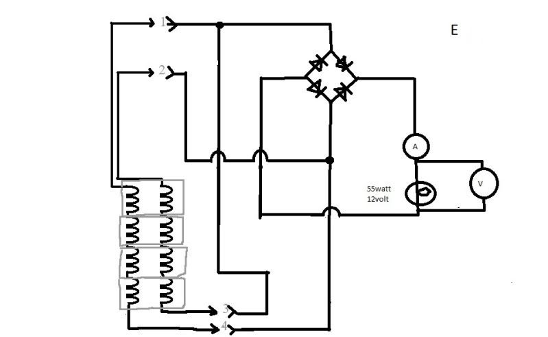

Back to 'standard format'...

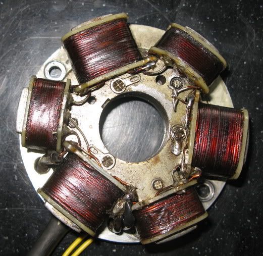

Six coil stator mod (two additional coils/bobbins/winding sets added to the two unused cores on the four coil stator), all tests at 3450 RPM.
Mikes E scheme, 2ohm, 6.4a, 17.4vac, 13.1vdc, 84w
Fullwave, series, 1ohm, 4.9a, 7.8vac, 4.8vdc, 24w
Fullwave, series, 2ohm, 4.7a, 13.2vac, 9.6vdc, 45w
Fullwave, series, 3ohm, 4.5a, 17.8vac, 13.7vdc, 62w
Fullwave, series, 5ohm, 4a, 24.7vac, 20.1vdc, 80w
Fullwave, 'the other side' 1ohm, 7.6a, 11.1vac, 7.4vdc, 56w
Fullwave, 'one side' 1ohm, 7.6a, 11vac, 7.4vdc, 56w
Fullwave, 'one side' 2ohm, 6a, 16.3vac, 12.3vdc, 74w
Fullwave, 'one side' 3ohm, 4.9a, 19vac, 14.8vdc, 73w
Fullwave, 'one side' 5ohm, 3.5a, 21.6vac, 17.4vdc, 61w
Dual half wave, 'stock parallel' 1ohm, 7.8a, 26vac, 7.6vdc, 59w
Dual half wave, 'stock parallel' 2ohm, 6.1a, 35vac, 12.6vdc, 77w
Dual half wave, 'stock parallel' 3ohm, 5a, 40vac, 15.2vdc, 76w
Dual half wave, 'stock parallel' 5ohm, 3.6a, 45vac, 17.7vdc, 64w

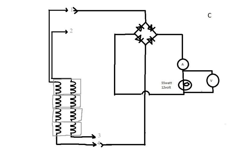

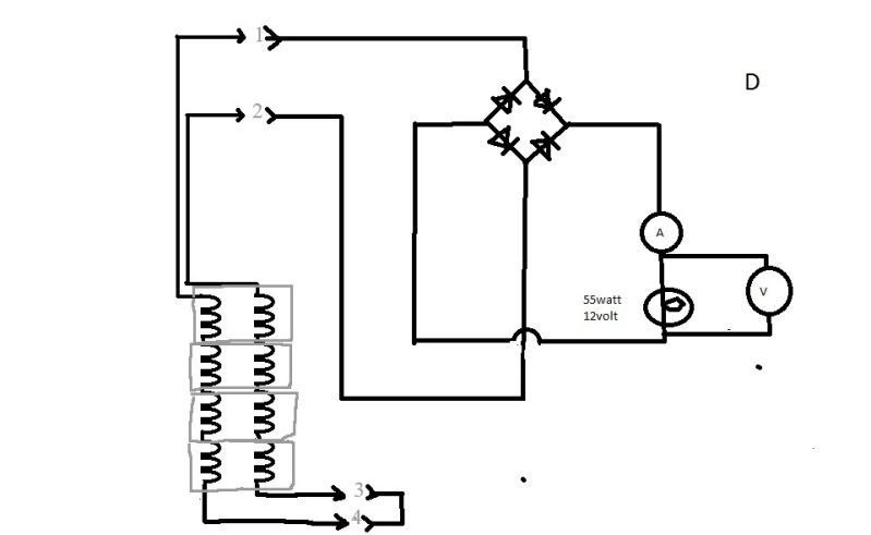

____ Thanks for your latest/final set of test-outcome result-figures for these established circuit-arrangements, Bill !
____ This first presented stock-like rectification circuit-scheme half-wave rectifies the AC-output of each alt.winding separately, and because those two stator-windings are 'wired-up' (not 'oppositely-wound') out-of-phase, the outputs from the single pair of diodes thus take alternating turns providing Positive DC-pulses to the charging-system. _ And due to the fact that the Negative half-cycles (of the full AC-cycles produced by each alt.winding) are all left ignored & unused, the stock rectification-system should therefore be referred to as: 'dual half-wave', (rather than complete "full wave" rectification, despite that the resulting wave-form may appear as normal 'full-wave' on an o.scope).
__ Note that the employed & depicted full-wave rectifier-block is wired-up to make use of ONLY two (of it's four) diodes.....
Dual half wave, ‘stock parallel’, 1ohm 3450rpm----6.6a, 21.6vac, 6.8vdc----44.9w
Dual half wave, ‘stock parallel’, 3ohm 3450rpm----3.6a, 28.9vac, 11.vdc----39.6w
Dual half wave, ‘stock parallel’, 5ohm 3450rpm----2.4a, 30.4vac, 12.vdc,---28.8w
____ This next presented rectification circuit-scheme full-wave rectifies the combined-output of both alt.windings connected together in the common/std.series fashion (which most everyone has naturally reasoned ought provide doubled power-output as well as doubled voltage). _ However, consistent test-results indicate that while the 'voltage' may indeed double, the 'power' obtained cannot be maintained (at higher values) while under increased load.
Therefore anyone who so converted merely to run a 12-volt system, is probably well-off enough,, however, of those who ALSO increased their system's overall running-load,
it's now been made clear that they've made the wrong modification-choice. _ As is clear by the very-low available power-output with the 1-ohm load-resistance.....
Full wave, Series, 1ohm 3450rpm-------------4.9a, 8.vac, 5.vdc-----------24.5w
Full wave, Series, 3ohm 3450rpm-------------4.1a, 16.2vac, 12.5vdc-----51.2w
Full wave, Series, 5ohm 3450rpm-------------3.4a, 21.2vac, 17.vdc-------57.8w
____ This last presented rectification circuit-scheme full-wave rectifies only one alt.winding (at a time), while purposely leaving the other dead.
The purpose of this one-at-a-time test, is to confirm that both alt.windings are equal, and also to help determine what effects might be in play when both stator-windings are in operation, either while in normal parallel-configuration or in non-stock series-arrangement.
__ Note that max.power-output (in this single-winding test), is a full 4-watts lower than Ducati's intended half-wave + half-wave (of each winding) type circuit.....
Full wave, Single winding, 1ohm 3450rpm-----6.3a, 9.7vac, 6.5vdc--------40.9w
Full wave, Single winding, 3ohm 3450rpm-----3.4a, 13.7vac, 10.3vdc-----35w
Full wave, Single winding, 5ohm 3450rpm-----2.3a, 14.7vac, 11.4vdc-----26.2w
