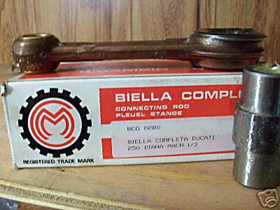

here is a pic of the box the Mazzucceli rods came in

I was told that the symbol on the rod i pictured was mazzucelli...maybe its not ? the symbol on the rod is hard to make out, but it almost looks like a Matchless emblem. Either way though, if having the oiling hole at 12 o"clock weakens it in that area, then what brand it is doesnt really matter i guess ?
