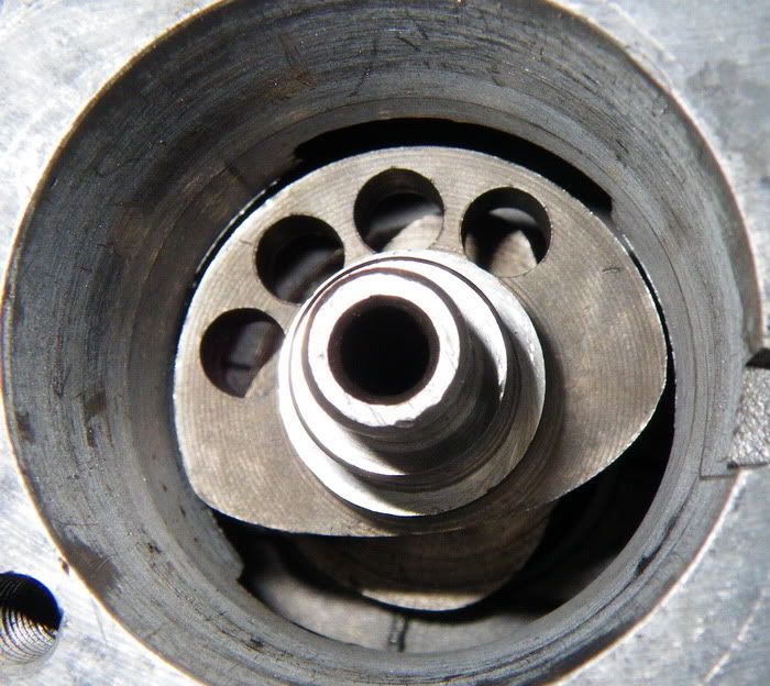

Unfortuately, my much anticpated VeeTwo camshaft fell through, which was disappointing, as I was looking forward to testing that. I was able to recover the existing camshaft with some very light stoning. Not sure how much hard chrome is on there, but I was gentle and there are no signs of wear through, so I'll give it a go and keep my eyes open for a Vee Two camshaft to try. Certainly the rockers did most of the sacrificing.
I think this is the stock Ducati cam, but I can't be sure. Here's a profile of the cam.

Re: W/C Oil pump
The cam doesn't look quite like mine with the 5 holes but it's in pretty good shape considering the rockers, I've seen desmoquattro cams that looked worse brand new, lol. Like Bob, I find it hard to believe that cam did that much damage to the rockers and came through that well. One thing to watch if the profile got slightly altered from the cleanup is binding, the openers/closers have to match very well or there can be conflict between the rockers.
Here's a pic of my 450 cam, you can see that the closer lobe closely matches the size and radius of the tunnel, even more so than it appears in the angle of this shot. I can see where a higher lift cam could require additional clearance to fit, unless the base circle is reduced to get the increased lift.

DESMO camshaft comparisons
Bill,
Thanks for the photo. I was comparing my cam last Tuesday night with a supposed Blue/White slightly used, and a new one. Both had only four holes and the lobes looked like yours. Mine has a noticably harder edge at the fifth hole in my pic (the one you don't have). The opener lobes were also ever so slightly different in profile. I suspect you and Bob are right and the cam has been changed, but this one was also subjected to some pretty serious heat at some stage in it's life. My cleaning up of this cam has been extremely gentle, with the object only (as Bob correctly surmised) to remove any burrs that might put any nicks on the new rockers (and to clean up the surfaces a bit to allow me to better inspect them).
I've checked the radii of the rockers and they appear perfect (as best i can tell). I'll be installing them without springs and will shim them tight to check for binding before backing out to factory settings. Fingers crossed!
Kev
Kev

In answer to DCT-Bobs post so far...
I think that assessment is probably correct (concurrs with wcorey's), but this cam had also been subjected to some significant heat leading to some blueing in places. In any case, I'm happy it will work fine for quite some period of time. (but i still want to test one of those VeeTwo cams, cause I like the specs of them!) Given my experience of trying to find Desmo rockers, i can well understand the possible approach (see below).
They were done through Phil Hitchcock at Road and Race. He has them the done by a shop in Queensland (R&R is in New South Wales) but I don't know who (although I plan on finding out!). It cost an arm and a leg, but as noone was thowing desmo rockers at me at the time (despite my best spruiking), I didn't feel I had too many options. The cost was AU$110 a rocker (just for the cam contact surface). I thought that was right up there, but on reflection, when you consider what's involved in the process, it's probably not an unfair price at all.
If I can, I will. (I get kind of twitchy when I have all the bits ready to reassemble!
Yes, I always carefully examine these. A key piece of info. The o-rings were intact, but the inlet o-ring had been nicked during initial fittment. Fortunately, not enough to allow any noticable leakdown. I've seen this a lot. My bevel mechanic mentor of many years experience has taught me to put a very light chamfer on the valve stem surfaces that cause this, and to do the initial fitment of valves with my hand cupped over guides to catch any o-ring nicks. Then I'll know I have to replace the o-ring and try again.

DESMO Rocker clearances and valve differences
let me report back on my homework assignment:
These measurements were taken using a digital vernier (or "very near" as my buddy refers to it as) so bear that in mind. I've taken readings at various places on the cam running surface. Generally speaking there isn't much variation edge - middle - edge
Inlet Closer Max - 41.16
Inlet Closer Min - 31.94
Lift 9.22
Inlet Opener Max - 31.15
Inlet Opener Min - 21.96
Lift 9.19
Exh Closer Max - 41.05
Exh Closer Min - 32.54
Lift 8.66
Exh Opener Max - 29.93
Exh Opener Min - 21.65
Lift 8.28
And now for something a little more bizzare. (and if that is an "odd" cam it might be involved in this scenario, so I'm interested to hear what people think about it.)
And this I did (which is where it got interesting). I was able to compare visually the repaired rockers with some brand new ones a friend has. As best I could tell, they look a perfect profile match (but that is an imprecise science!). I installed the refaced original valves, the repaired inlet rockers and the cam and the closer shim arrangement (collets and retainer - but zero shims at this stage and no springs) and tested the rotation of the cam. Guess what? The inlet cam reached the valve seat before maximum closer lift was reached on the cam. Bear in mind these are not new seats and I have just recut them, so they have been cut at least twice. There were only three logical explainations to me...either the rockers had a whole lot more material on them than spec after the repair (which didn't appear to be the case when I looked at them - but it ain't easy to be sure) or the inlet valve is too short in the distance from the valve head to the valve stem collet recess, or both.
I did notice when I dismantled the assembly, the intake closer had zero shims installed and I now suspect the collet retainer has been machined down too. Never having worked on a desmo single before I'm not familiar with the specific dimensions of the valves. I got a friend to take my valves with him to compare against his 450 desmo valves. I don't think they are original either, but he reported back that my inlet valve overall length was exactly the same as his, but the distance from the valve head to the collet recess is 2mm greater than on my valve.
I didn't get onto the exhaust side last night as i was trying to get my head around this lot.
If anyone has a set of old Ducati 250 Desmo valves sitting around, I'd very much appreciate finding out overall lengths and a reference point for the collet recesses for both valves.
The amazing thing is that, it's quite possible that the only thing that allowed the cam to rotate at all when the engine was last running was the material missing off the damaged rockers!!
Kev
