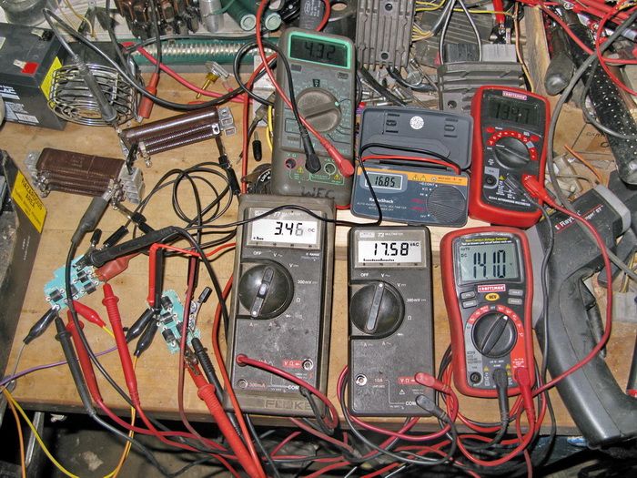

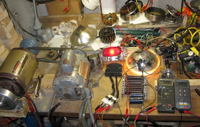

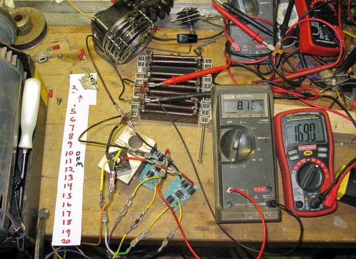

You don't recall all those dozens of test setup pics with the results being displayed in real time? Some with three separate rectifiers running the sectioned out alt in various configurations at the same time?
Like these, for example?
You were the driving force behind a good proportion of the testing and were asking the very same questions about the results then as now.

" You don't recall all those dozens of test setup pics with the results being displayed in real time? Some with three separate rectifiers running the sectioned out alt in various configurations at the same time? "
____ Oh-YES, but of-course,, how could ANYone not !? _ I just don't recall any such magical-like results,, so that-mystery must've been from later, nearer-to the end.
" Like these, for example? "
____ Yes Bill, (I'm sure everyone's quite IMPRESSED, as I've always been !).
