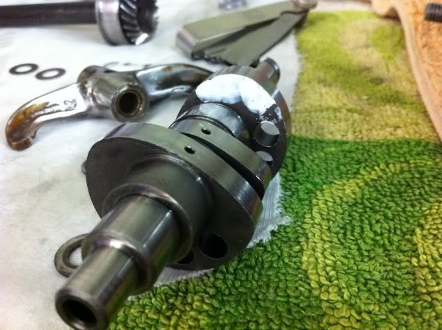

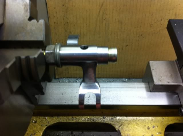

Light springs.
Turn down the closing rocker to fit the springs.
The white section needs to be lapped down, This is the first part that closes the gap between the opening shim.
The tight spot then moves towards the "flat" section of the closing rocker which then needs lapping.
Does this make sense?
If you remove the springs, shim the closer as normal and shim the opener tight, like .03mm and roll the cam through 360 degrees it will close the .03 very quickly and bind.
Even set at .1mm most cams I have seen will bind where the valve starts to open or close.
It takes a long time to do with a diamond lap but the opening clearence remains constant throughout 360 degrees.
Some 450 desmo cams are worse than others.

I like that spring mod, very clean implementation. I hear some don't even run springs, I guess compression closes the valve once running and the springs are only there to facilitate starting. So if you run zero closing clearance the springs wouldn't be necessary at all but since it seems apparent that most of the cams don't allow zero, I have to wonder if that's why the springs were originally used.
I went through a similar arduous process with my cam, even knowing I could get away with the extra clearance, it just didn't seem right to run it that way. Didn't take the extra effort to get it spot on as I was concerned about going too far and having to resurface other area's of the cam to get it back, big improvement though.
DESMO Closing-clearance Consistency Matters
By: graeme...
" shim the closer as normal and shim the opener tight, "
____ So exactly how are you shimming the closer "as normal" ? _ As however done, that's no-doubt the source of the binding issue ran-into ! ...
__ It's understandably obvious that Ducati MUST have meant for the recommended "0" closing-clearance to be set at WHATEVER point in the camshaft's 360-degree rotation where it can actually be done WITHOUT BINDING ELSEWHERE within the complete rotation, and NOT set to zer0 at TDC (as many assume) !
The reason Ducati could get-away with the sloppy cam-ramps (which can lead to possible binding), is because they depend on the valve-springs to complete the v.closing-job that's merely only mostly done by the closing lobes & rockers. _ So therefore the only reason for actually needing the closing-clearance to be set at zer0, is to cut-down on slop & noise as much as possible. _ And the resulting closing-clearance slop (up to about 1mm) is not a real issue !
" Even set at .1mm most cams I have seen will bind where the valve starts to open or close. "
____ Yeah but, ".1mm" at WHAT rotation-point ? _ TDC ? _ If so, then that's obviously of-course the WRONG place to shoot for '0' closing-clearance ! _ Logically quite simple actually.
" It takes a long time to do with a diamond lap but the opening clearence remains constant throughout 360 degrees. "
____ I hope my view-point is not misunderstood though, as do I agree that the consistency-work (done at the points of possible binding), is indeed fairly 'nice' to have, and perhaps even necessary if closing-springs are eliminated. _ It's just that most others don't really have to feel the need to have their-own D.cams reworked to become so consistent (in constant clearance) ! _ As it makes no useful difference so long as the valve-springs remain functional.
Still though, the unneeded consistency-work makes for a sort of hobby-pleasure, (if nothing more).

Re: RT Rebuild and questions
Hello Bob,
I'm new here and don't intend to offend, so forgive me if I do,
I set the closing shims at 0. not by measuring but by feel with the springs removed and one closer at a time, so I can feel the interference.
Not particularly at TDC but where the closing rocker is keeping the valve closed by its curve.
Then fit the opening rocker shimmed tighter than the Ducati recomended clearence. This is NOT what I run the engine at, just on the bench.
I know the closing rocker will rotate freely as it was the first one set.
Rotate and feel the closing gap dissapear and make it impossible to keep turning the cam.
Even if the opening shim is set at Ducati recomended clearence most 450 desmo cams I've seen will close the gap to nothing or bind, damaging rockers and cam lobes.
This is a desmo cam that shouldn't require springs at all, and the bear traps that are original must sap what little power there is and also load the bevels and Oldham coupling unnecessarily.
I understand why Ducati used these springs on their first desmo released to Mr public.
A desmo cam should maintain the opening clearence throughout 360 degrees (without springs fitted) or risk damaging cam or rocker surfaces if and when the clearence closes up due to heat expansion. (or poor grinding)
Take the springs out of a 450 Desmo head and set the clearences as per the Ducati manual then rotate it through 360 degrees by hand and you will see. Try the same test on a Pantah head or anything later, no binding as the cams are ground much better.
I agree that not every desmo owner has to do this, and I didn't for years, but it does make a difference to how they go.
And I do enjoy trying to set an engine as Dr T pened them.
Regards
Graeme

Workable DESMO Rocker-clearance Setting
" I'm new here and don't intend to offend, so forgive me if I do, "
____ One's wording ought be pretty-openly blatant before another takes any offense, since written-wording alone can often be somewhat easily misinterpreted.
I-myself dispense with any hugs & kisses within my chosen-wording, and so then my neutrally worded wording is sometimes thought-of as possibly negative (which is never meant to be the actual case).
So ditto back at you.
" I set the closing shims at 0. not by measuring but by feel with the springs removed and one closer at a time, so I can feel the interference.
Not particularly at TDC but where the closing rocker is keeping the valve closed by its curve. "
____ That's fine so long as what you mean by "it's curve", is the closing-cam's 'max.peak'.

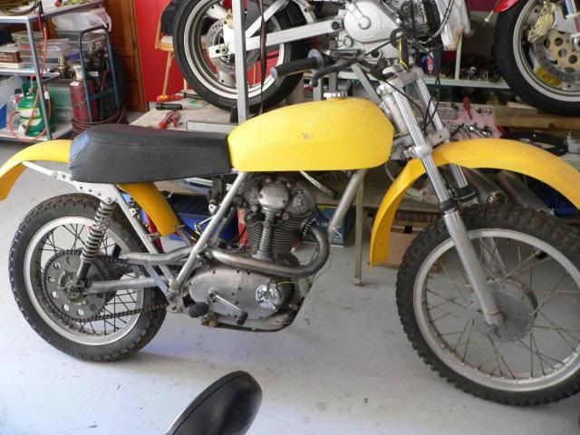

PhilA wrote:Wouldn't be a lot easier to fit R/T TS parts (assuming they can be found)? Still 6v I realise but at least you'd know it all fits and works. Not to mention it keeps the bike "original".
As per:
http://www.philaphoto.com/imageLibrary/ ... m=54&pos=1
Phil
Hello Phil,
That sure is a nice looking TS.
I've never seen a real one only RTs
The "bolt on " parts are very hard to find in Australia. There are some reproductions but the quality isn't good.
As much as I would like to rebuild it to original, it will hopefully look close to what it was originally.
Thanks for the picture of your TS for reference.
Here is what I started with, unloved and unwashed, with hand me down baggy pants.
and where it is up to now,
Regards
Graeme
