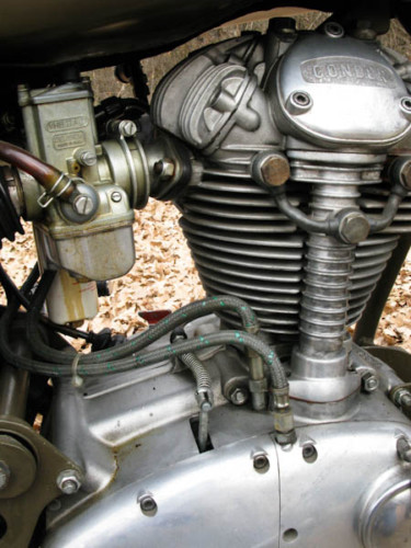

the Condor ducati powered swiss bikes had a setup with an external oil filter. I will be interested as well to modify my oil pump cover to do so too...
Greg
Greg

the Condor is not a full flow setup . only the oil to the cilinderhead gets filtered .
i pressed a few Condor crankshafts apart and cleaned the sludgetraps .
there was just as much sludge inside the trap as on engines without a filter .
i seen destroyed rockerarms and camshafts from engines someone fitted a external filter to .
if the internal pressure from the filter is higher as the pressure the bypass valve behind the oilpump plate opens at ( the little ball and spring ) al the oil get dumped and no oil is getting to the parts that need it .
when fitting a external filter i would weld up the little bypass hole it the pump backplate and have the plate ground flat again
