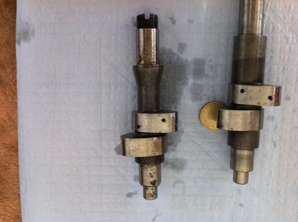

Also,
I've been cleaning up and putting away parts (for moving) that have been collected over the years.
I've found a cam that has the shaft beveled down ( tapered) that is 120mm long, is this a narrow case cam?
And some springer cams that are 126 mm long, wide case 450 I presume?
Desmo cams are 130mm long.

" I've found a cam that has the shaft beveled down ( tapered) that is 120mm long, is this a narrow case cam? "
____ Well that seems to be a fair deduction but, all 250*/350/450 (*except the 69x66mm 250) n-c & w-c models have camshafts which are of the very-same length, of 126mm !
__ The shorter camshafts are from the 175/200 models, which have cylinder-heads that have a 'square' bolt-pattern...
The 250-models (with the 74mm-bore) needed to have their left & right bolt-pairs relocated/widened-apart (for the larger cylinder & head bore-size), and-so at that time, the camshafts got widened/(lengthened) as well ! _ Although such was not actually needed to be done, as the shorter camshafts will fit & work within the newer cyl.head design. _ I-myself have even done so but, I then prefer to fit a wider bearing into the bearing-support cap/cover.
__ If you could, it would be nice to see a picture posted of your 175/200-camshaft, (preferably placed side-by-side with your longer n-c.camshaft).
" And some springer cams that are 126 mm long, wide case 450 I presume? "
____ They all must be 250/350/450 n-c/w-c camshafts !
If you post pix of them all, I may then be able to identify their cam.models for you.

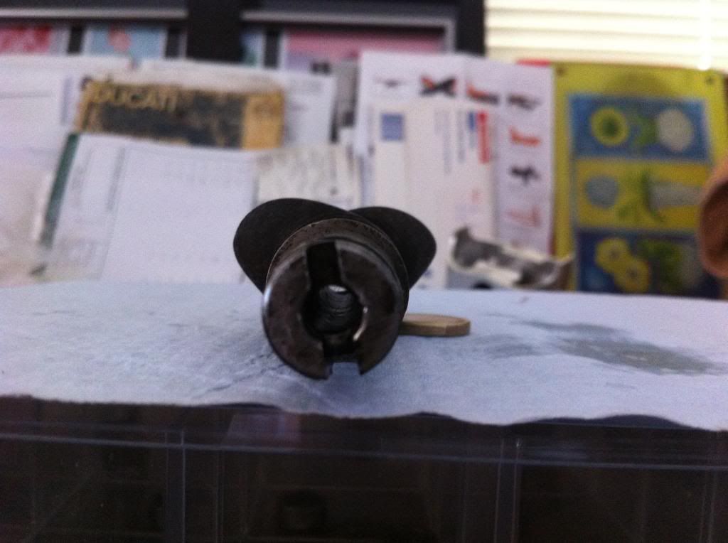

Postby graeme » Tue Feb 12, 2013 10:52 pm
Hello Bob,
I've added some pictures of the cams in question as I mknow you like pictures,
Regards
Graeme
Re: 450 and cams
Postby DewCatTea-Bob » Tue Feb 12, 2013 11:23 pm
" I've added some pictures of the cams in question as I mknow you like pictures, "
____ What a perceptive coincidence,, as you must've posted them just as I was writing my wording suggesting that you do such ! _ Cuz I just-now noticed them posted, right-after I just posted my next-to-last update to my-own post, (which is now finished).
____ I've now adjusted one of your pictures of your M1-cam and placed it side-by-side with the cam.model which ought to be in your stock 450-Scrambler, (in hopes of making the obvious difference in their cam-lobes easy to notice).

The 175/200cc cam was in with some 450 parts I was lucky enough to buy.
