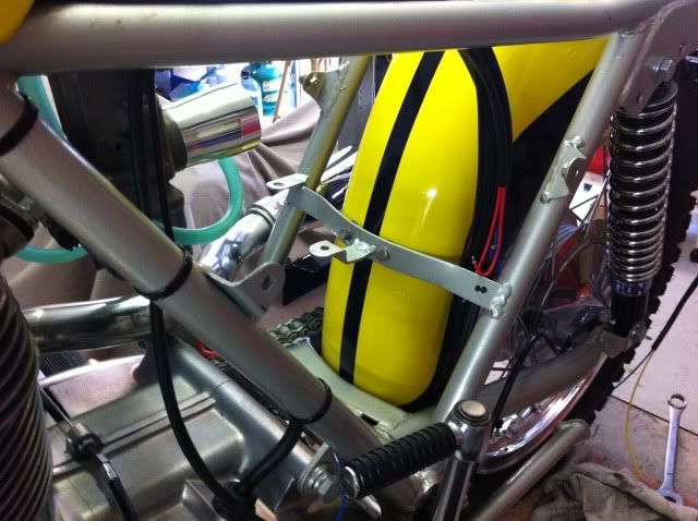

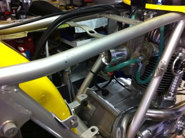

Anyone fitted a battery to an RT?
I'm trying to figure out the best way to make a battery tray that keeps the battery down low so there's room in that area for ignition box and regulator. (and an after market air cleaner, like a cone shape k and n)
Any pictures?
The mounting points available are the top and bottom mounts from the original air cleaner, and maybe the seat bolts and possibly the top rear engine bolt.

Hi Graeme,
It sure looks light space is at a premium. I have no experience to offer, but If it were me I might fit the airbox and regulator and then perhaps out of cardboard construct the biggest box that will fit without physical conflict or airbox obstruction so as to know the maximum size of battery you might buy. That might also help you determine the location and size of shelf, as well as mounting points.
My Sport has its battery up high, virtually along the inside wall of one of the side covers. Any room there?
I am not sure how spill-proof/rupture-proof any of the many new families of sealed batteries (such as glass mat) are, but if you are willing to take a chance you might find some room up under the seat to stash a small battery on its side or with its terminals facing down.

Hi Jim,
It's clean because it hasn't come off the bench yet.
I think I've figured out a solution that will work and the vibrations won't destroy.
I'll post a picture later.

Postby graeme » Sun Jun 24, 2012 7:39 am
Hello Bob,
This RT has a Scrambler alternator and flywheel,
Reg. rec. from a square case twin,
Sachse ignition,
Acewell speedo/tacho/odometer,
Thus the battery.
None of the above make this a better RT than the next one, just easier to live with for me.
I've just about figured it all out, just waiting for paint to dry so I can fit it all together.
I'll post a picture when it's together, might help someone one day.
Graeme

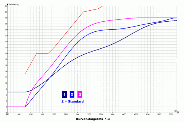

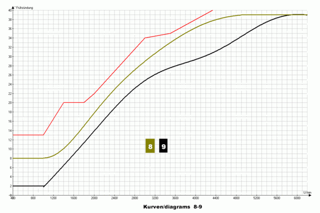

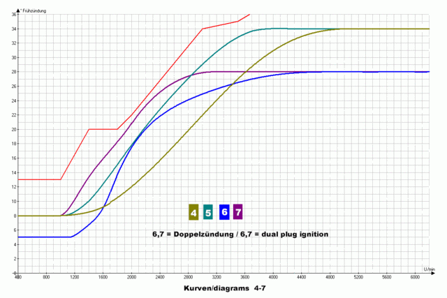

Postby graeme » Mon Jun 25, 2012 1:05 am
Thank you for your advice Eldert and Bob,
Here are the advance curves available with this ignition.
A friend is using this ignition on his 450 desmo and likes it, that is why I bought it.
My '74 450 has the original Ducati Electronica red box, which works well, but it breaths better than standard.
The RT is standard.
Graeme

Postby DewCatTea-Bob » Mon Jun 25, 2012 1:15 pm
" Here are the advance curves available with this ignition. "
____ None of all the 3-sets of adv.curves you've presented offer the optimum curve I-myself would choose for a 450-Duke but, the black-curve (in your top graph), if retarded 2-degrees, looks to be the closest/best-choice (of all those 12 choices), in regards to ign.advance-RANGE,
(of-course assuming that the limit of advance is indeed reached where the graph leaves-off).
However it's curve is not quite steep enough to suit me either,, as compared to stock (being at 28-degrees by 3000-RPM), the black-curve would be near 5-degrees retarded, (only reaching 23-degrees by 3000-RPM).
__ The pink-curve (in your center graph), is a little-bit steeper, reaching 26-degrees by 3000-RPM. _ But that adv.curve would only range-out to 30-degrees max, (if also retarded 2-degrees [so as to match the stock 0-degree static-setting] ).
So, either the black or the pink adv.curve would be a compromise, so it seems you have to choose between them by deciding which advantage (range or steepness) most appeals to your favorite preference.
Or perhaps you could ask if a customized adv.curve could combine the best of both black & pink curves ?
Still, I'd prefer an even steeper curve (than even stock), from 2-degrees ATDC to 32-degrees BTDC by 3000-RPM.
____ I wonder which of all those adv.curves Eldert (or anyone-else), thinks would be a best-choice !?
