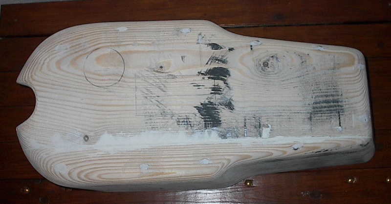

if you have plenty of time to spare : GO FOR IT
dont underestimate the work involved . ( and the workshop gets very messy )
last month i made a wooden buck to have a stab at making a aluminum tank
thats about how far i got .

Yeah Eldert! That is super-cool... out of wood no less. Are you going to use that as a buck to form alloy panels? Then weld them all together?
