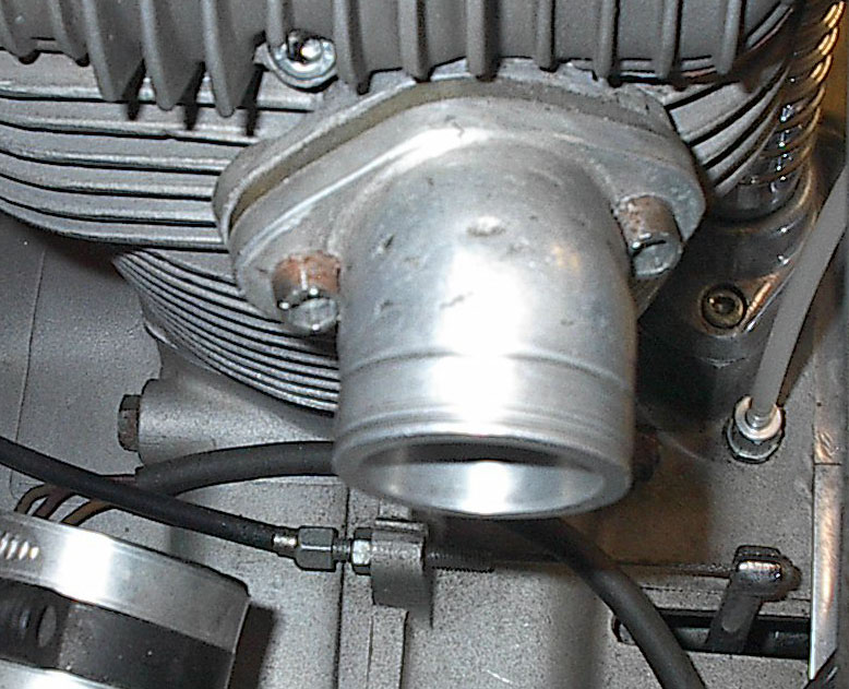

Hi Graeme
sorry for the late reply but i did make a manifold for a 34 mm carb for a RT a while back .
the manifold is made up out of 3 pieces and there is a wedge in the middle .
i used aluminum . there was no room for the M8 nuts so i used turned down and tapered allan head bolts
to mount the manifold to the cilinderhead .
i also removed the seatbracket . original it is located in between the framerails and there is a spacer under the seat .
i put the bracket on top of the frame rails and used a 2 mm spacer . this gave me about a 1/2 inch
more room for the carb and throttle and choke cables

Thank you Eldert,
It's never too late for your advice.
I used the 32 and manifold I had from the Scrambler, but I wish I had moved the seat bracket to the top of the frame rails, that would have saved heaps of mucking around. Next time.
Do you have any advice fitting a larger manifold and carb to a 450 Scrambler with the 450 frame gusseting? These are very tight.
